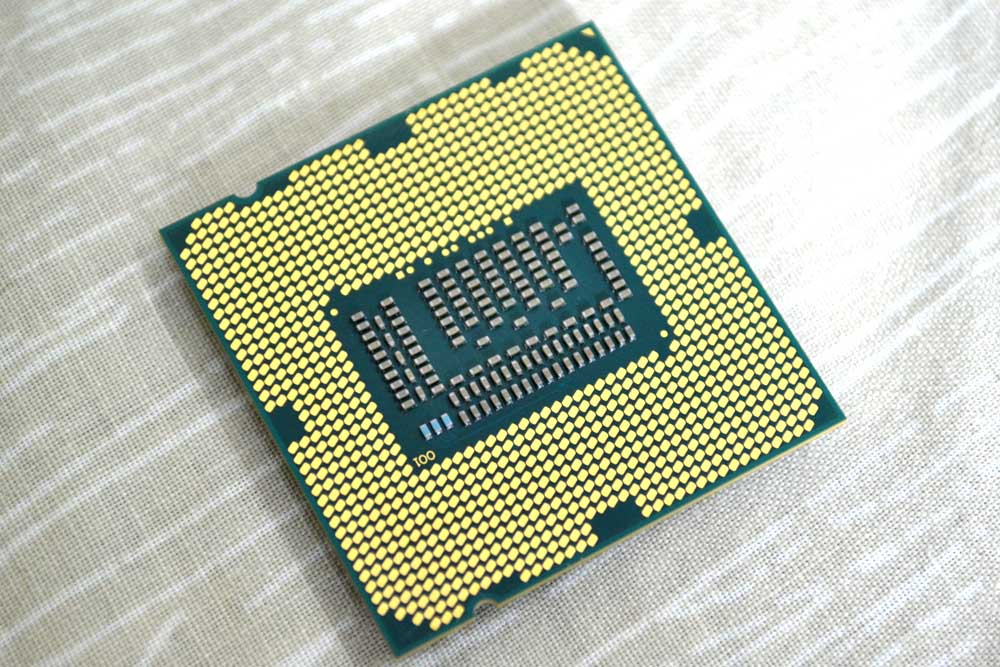

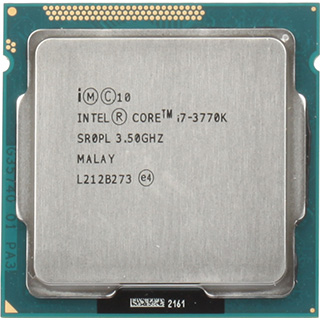

let me start by saying i am not experienced with the projects i read on these forums. i build computers. well "build" is a strong word. i plug in parts and refer to it as building.

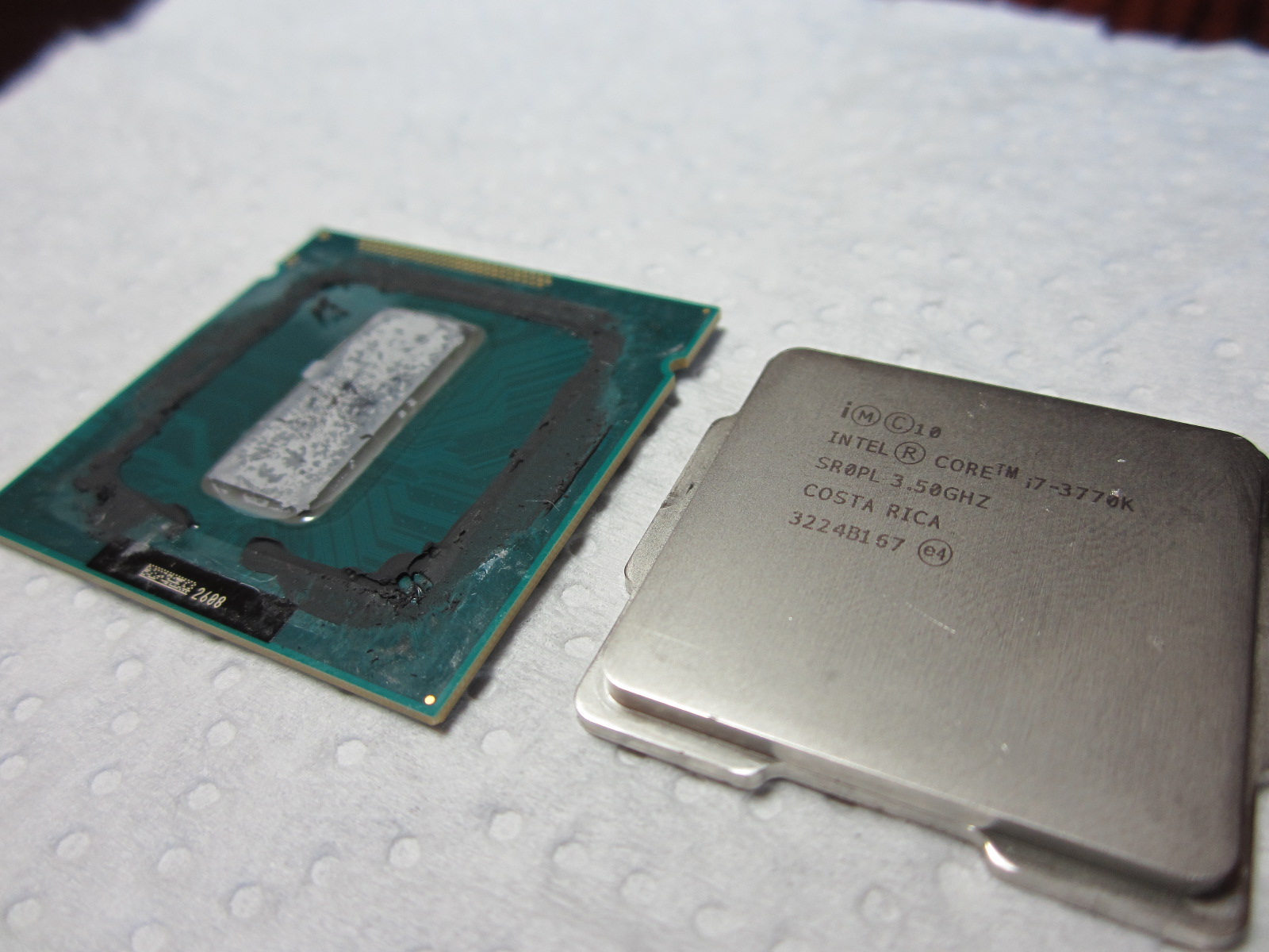

anyways, there is a process called "delidding". delidding refers to the process of replacing an oem thermal paste between the die and lid of the processor with the goal of reducing operating temps. i want to replace the oem thermal paste with solder rather than just using a different thermal paste but dont know how to go about it. i am considering reflow soldering (not experienced with that either)
Any suggestions/ideas are much appreciated.

Solder conducts electricity. Thermal paste does not conduct electricity. Then replacing the thermal paste with solder will short everything together. Thermal paste is made to conduct heat so maybe it is a better conductor of heat than solder.

Solder will not adhere to the surface of the silicon and will have lots of air trapped underneath it. Also you can easily damage the chip this way.
I suggest you change the paste, and/or use a different heatspreader. You could try using liquid metal thermal compound directly, but no idea if its conductivity will come bite you in the ass.

This is totally wrong , the die is only connected to the HS via a tiny thermal paste layer witch helps conduct the die's heat to the hs and next to the radiator .
In the other hand there is a metallic thermal paste

How about just cleaning up and polishing the top of the die and directly mounting your cpu cooler on the die (with some TIM of course) as done by some overclockers?

I would rather ask what kind of coating is on the bare chip die. I really wouldnt risk ruining a 200$ processor just because I want to get 5°C off the die temperature. If the die is not perfectly closed by some kind of coating, then the liquid metal could leech inside and amalgamate the silicon, which you really dont want to happen.
I share AG's concerns about electrical shorts if solder or a metallic paste or metal-containing paste is used. There is also the possibility that an electrically-conducting layer so close to the die will increase parasitic capacitance, which could affect signal propogation times and lead to race conditions.

My advice is use the metallic paste on the heat spreader and not the die , and mx 4 between die and HS .
