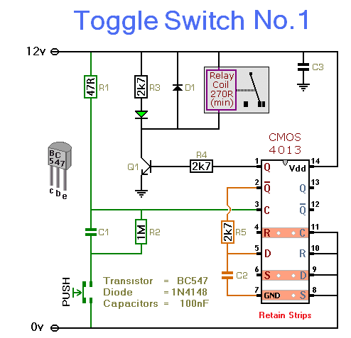

Hi Guys how to toggle this switch electrically without touching physically.

The circuit is a 4013 D type flip flop set up as a bi stable switch. Pressing the PB changes states, pushing it again changes states again. The clock input is pin 3 so if you clock pin 3 it will change states. How you clock it or waht you clock it with is up to you. I don't get what you are asking or wanting to do? In your circuit we are turning a relay on and off with button presses.
Also since the chip is a dual FF you are only using 1/2 the chip in the drawing.
This link may better help you understand the chip. Ron
Seems pretty clear to me: the O.P. wants to trigger the circuit without manually pushing the button.
So wouldn't a simple transistor circuit work here? Connect the C and E of the Q to where the switch is now; drive the Q into saturation to close the switch? Could be triggered from practically anything.

Yeah, but it's a pretty open question. I want to change states of a D flip flop without using a push button switch. Well run anything in for a clock. :)
Doesn't want to use the button but does not mention what they would like to use. The link shows a clock driving the clock in. Maybe that will amuse them.
Ron
Well, it could be a signal from any number of other circuits or devices, couldn't it, Ron? or a microprocessor.
