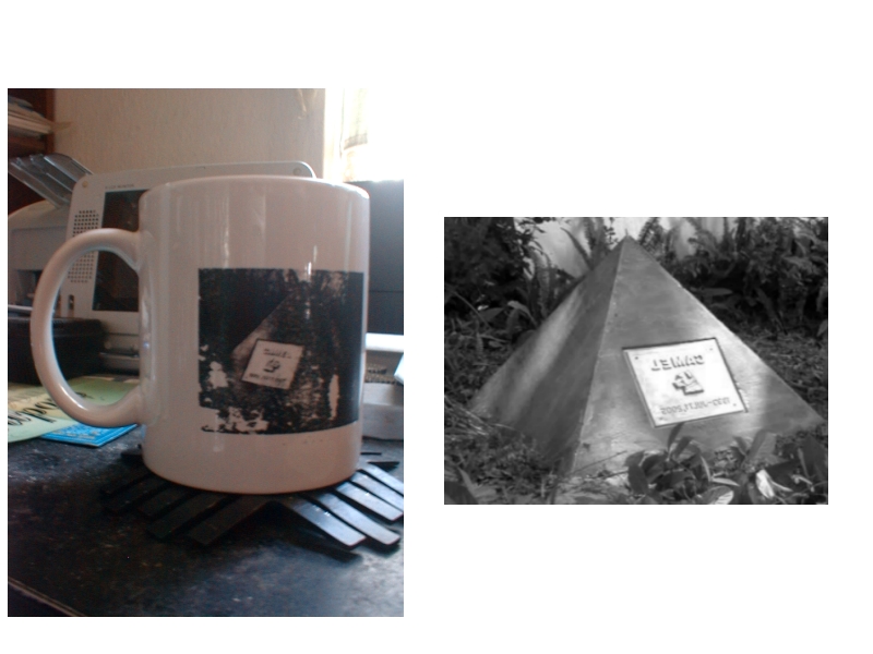

I picked up 4/$1, plain white, ceramic coffee mugs. Basic, generic, straight sides.
Figured I could transfer some graphics using the same PCB method. Now, the blue transfer paper is a little spendy to play with, and I use a laminator for PCBs.
Basically looking for some suggestions on paper that will leave a clean transfer. Thinking of try the Staples brand photo paper I got, before getting the good blue stuff. Transfer pretty clean, but seemed the backing got a little melty, like plastic (got a little concerned about my printer and laminator, so stopped using it after a couple of boards).
Also, will have to use the clothes iron to apply. Not sure how this would work on a curved surface, or if I'll be able to get enough heat to do the transfer on ceramic. Had some thoughts of cuting some sheet metal to size to cover the paper, held together with a couple of springs or a screw clamp. Either baking it the oven, or using a propane torch.
Anybody got any experience with this?

The clothes iron wasn't getting hot enough, think it would take a very long time. Guessing the whole mug needs to get hot.
So, I cut a piece of sheet metal (should have measured...), to covered the paper, was a little short, so wrapped some aluminum foil over the paper, then put sheet metal on top. Couldn't find large enough hose clamps (wonder what the hell I used them for...), so bolted some plumber strap over the sheet metal, made a pretty good clamp.
Put the whole mess in the cold oven, and cranked it up 300 degrees (really have no idea, old stove with most of the markings worn off).
The picture shows how it came out, and what I put on it (should have lightened it some). Only one small area didn't stick. Seems kind of permanent a as well, have to really pick at it to get any to come off.
The oposite side didn't do well at all, about 1/4 of it didn't transfer. Might have been I didn't wait until it was cool enough when I picked up that edge to see if it stuck.

Good work.
Maybe the problem is uneven pressure. If you could find some sort of rubber sheet to put between the sheet metal and the image? (?Silicone?) rubber comes to mind but I do not know how easy it is to find.
Some swimming hats are made from silicone rubber which should tolerate 300°C for reasonable periods of time.
Try a good cooking store. I have silicon reusable bakeing sheets which are just 8/12 X 11 sheets of perfeclty flat silicon, it's pretty thick though.
