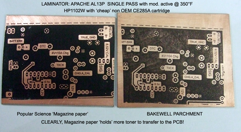

Hi all:
I did a comparative 'magazine paper vs parchment paper' test. The parchment was cleaned with isopropyl before printing. Both transfer papers were taped to regular copier paper when printing to avoid crumpling and paper jams. Here are the results:
This is the laminator mod used:
https://hackaday.io/project/3363-apache-al13p-laminator-one-pass-pcb-toner-xfer

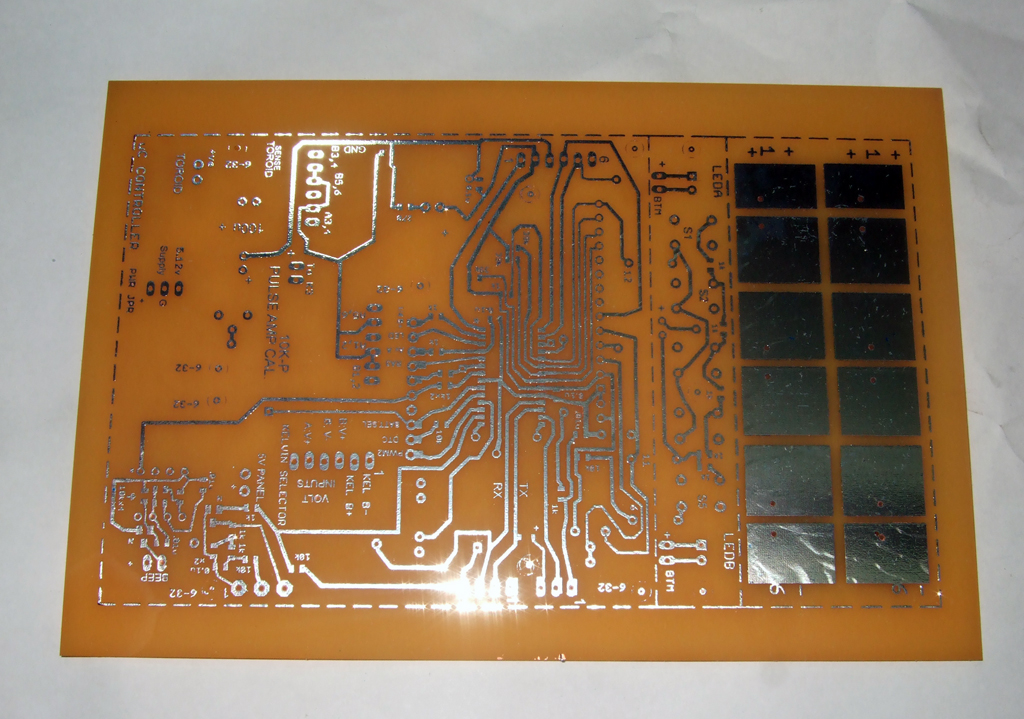

In addition to Sarma's rec. above....I've found this foil to work well for PCB making.
https://www.ebay.com/itm/160937797413?_trksid=p2057872.m2749.l2649&ssPageName=STRK:MEBIDX:IT
It is much cheaper (50%) than the green TRF sold by the Pulsar paper folks.
https://pcbfx.com/main_site/pages/products/toner_foils.html
I prefer the 4" wide version as it suits the PCB size I work with.
BTW: It took me 25 minutes to prep a 4" x 6" dbl sided PCB, 220 grit sanding, marking registration holes for double sided thru hole alignment, drilling the holes, printing, trimming & attaching both toner transfers, laminating them, then laminating double sided foil transfers. Add 5 minutes etch time = finished PCB in 30min.
Foiled PCB:
Etched PCB: Blue transparent plastic washes off after etch leaving a metallic mirror finish bonded to the underlying toner.

I too have had failures during learning time. I have found with the cheap Chinese paper that the bigger the artwork the greater the chance of having dramas. The paper is very thin. I either have difficulty removing the paper and or fail sometimes to transfer some of the tracks and donut pads to the board with the toner still remaining on the paper.
I purchased many moons ago some slightly more expensive and thicker paper from South Korea. It was a lot more forgiving with the amount of heat and duration of the heat. Unfortunately this seller on eBay has no more paper to sell. I purchased only 20 sheets and quickly used them all on an run of power supplies that I handmade and sold on eBay.
Well I have some of the yellow paper ordered. I note the pulsar paper is backed by thicker stock, perhaps to even out the heating. I could always add a sheet of copy paper during the lamination process. I'll do some testing when I get it as I have a modded laminator with good control.
