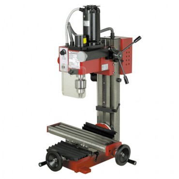

I use a small mill.
I have used a soldering iron with a knife blade attached.
If it's melting the plastic the blade is going too fast, you may be using the wrong type of blade as well you want course teeth. Any particular reason you chose polycarbonate? Thin sheet metal is pretty easy to work with, and provides RF/EMI isolation as well. It takes a little more time to work with metal as it cuts slower, but you can also bend it much more controllably than most plastics by simply scoring the bending point to create a week point and using proper leverage with wood blocks and a pry bar.
Here are a few hints about cutting plastics:
1) Generally, plastics tend to "hog" in. Use a negative rake tool (https://en.wikipedia.org/wiki/File:Metal_Cut_diag.jpg). That gives you more of a scrapping action than a cutting action. The previous post about using a saw blade installed backward simply is another way to get negative rake.
2) If drilling, "dub" off the cutting lip. In other words, grind the cutting edge so its contact angle with the plastic is perpendicular or a little past. That also gives negative rake.
3) I use the Harbor Freight version of the mill shown in #13. Don't trust the downfeed dial. Put a cheap dial indicator on the spindle housing and use that to gauge your depth of cut.
4) Use water cooling, if possible. Some people add a little detergent to enhance wetting.
John
Thats exactly what i use. Water and dishwashing liquid. I had to regrind the bit ends to drill 5/8 holes. I made them look like a pilot or brad point bit.
