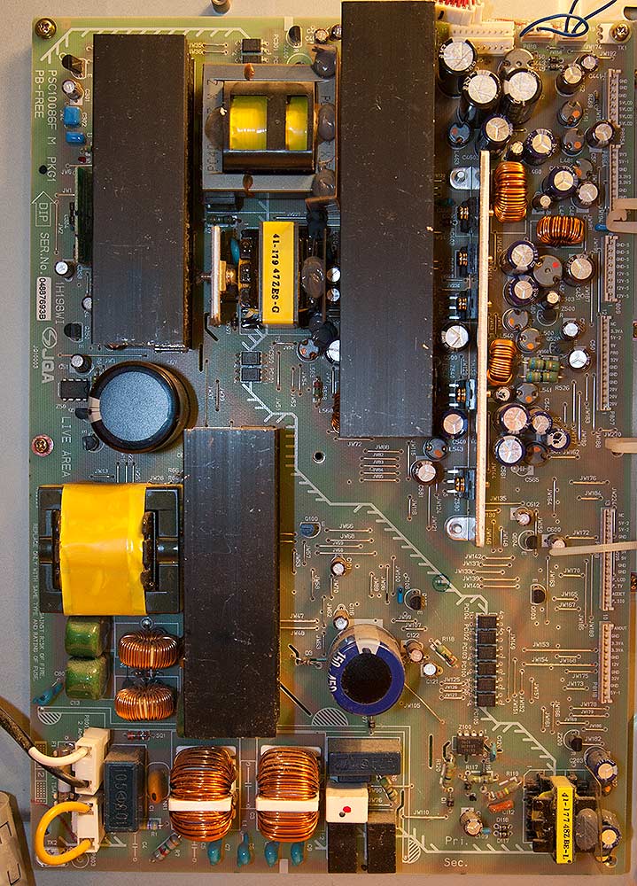

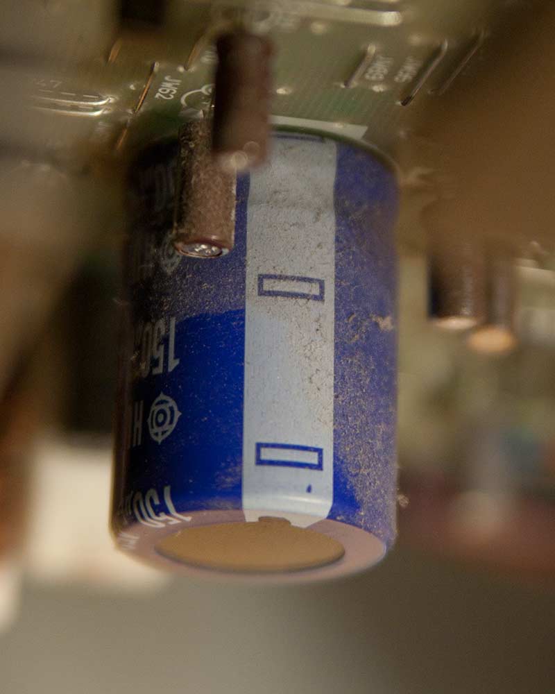

Hi everyone, I have the aforementioned tv, it displays a red standby powerlight but when switched on the set does nothing and the led turns off. I am fairly certain the problem is in the main power board as I am not getting the correct readings on the test pins. There is a 150uf 450v cap that is very slightly bulging in the primary, all the other components looks ok, has anyone else worked on a similar model, if so what did you find? Do you all think that one cap is capable of making the whole thing not function or should I be looking at the transistors as well? I can post pictures if you want to see them. thanks Caleb
A photo of what you consider 'slightly bulging' would help; no cap should ever be distended even a little, they're manufactored perfectly flat. I would replace it by default before going any further if it is in fact domed in any way.
The chances of a bad transistor causing the failure are... VERY low; the chances of a cap causing it are VERY high. The cap failure causing another component to fail is highly possible, no reason to conjecture till you post some pics. If it's actually bulging in any way shape or form replace it and try again.
Ok here are two pics, one overall and a closeup of the cap in question located near the bottom in the center. I was wondering about the transistors as there is a row of them (MS 7pc123) connecting the primary and secondary.

thanks for chiming in Nigel, I tested the outputs on the right side of the board as they are labeled for voltages, I get the correct voltages on a few but nothing on the rest. I downloaded the service manual which was very unhelpful as it doesn't go into diagnosing the boards themselves, just says replace. Anything to look for on the main board as common failures?
The PSU should produce at least one voltage in standby, the main board then sends it a signal turning the rest ON - if it's not been told to turn ON, then you would usually only get 3.3V or 5V, the standby supply for the processor.

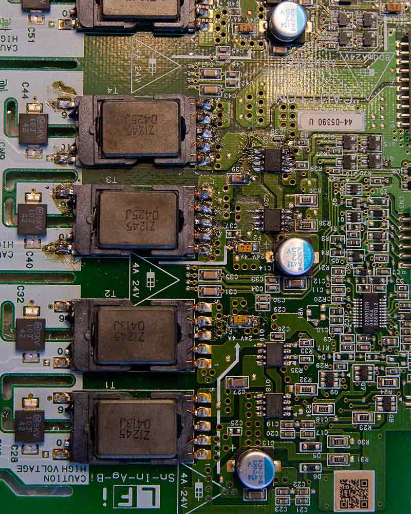

update> I went ahead and opened up the panel exposing the inverter board, someone has been here before me as the lead to one of the cfl's was unhooked and the board has seen better days, the second set up was unhooked, but looking at the state of the board I was wondering what caused this to fail? It obviously got quite hot as some of the components are melted. the transformers themselves ohm out as ok but the control circuits are going to need some work.
I tried to resolder the existing components but alas still no backlight, the mosfets that were melted off the board are no longer made, so I may try to get the next closest chip or if I can find a good deal on a replacement board I may have to go that route.
I'm not to familiar with these circuits it tries to power up for about 3 seconds then shuts down I assume something is shorted on the board and the control chip is shutting off the circuit is there a way to test the mosfets with an ohm meter? they are a https://www.fairchildsemi.com/ds/FD/FDS6990A.pdf
I went through and metered all the mosfet legs and found the two that were melted were shorted out, do you think this was caused by the unhooked bulb or did the repair tech unhook the bulb because the mosfets were bad when they worked on it? All the fuses are intact so I am still wondering what caused these two to have a meltdown. how important are the tolerances on these to the micro controller as the replacement chips that are in stock have slightly different capacitance values?
