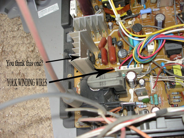

This look like the chip. I can hook the scope on it and see what I get if so. I hate that flyback being right there.

No, that's the line output transistor - the frame scan coil wires are the right hand two wires on the connector, and presumably go off towards the right, where it's off the picture.

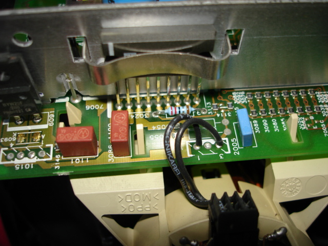

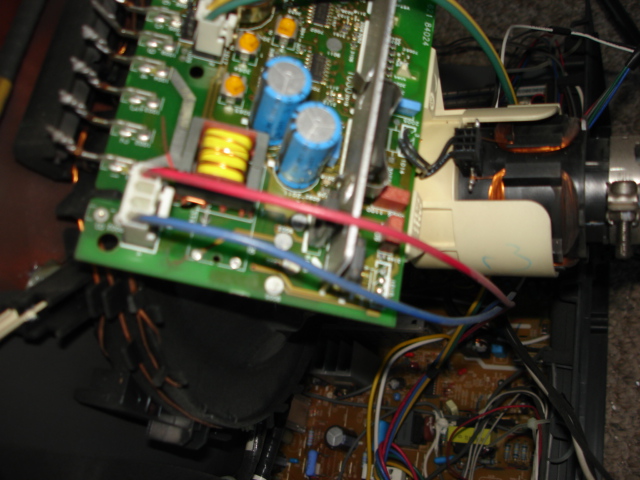

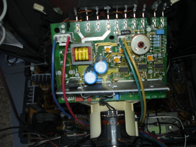

Both sets of wires go to a board on the yoke/crt. Here is the board. Hope it is a part on there rather the main board. It is a lot easier to get to. Thanks for the help Nigel.

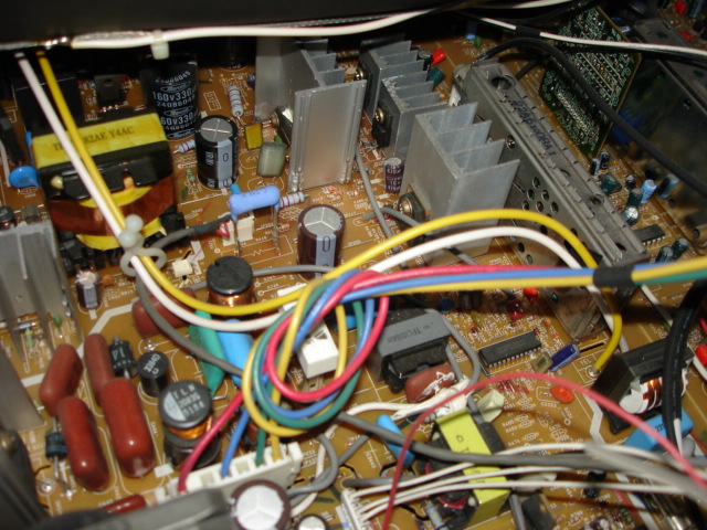

Here is a shot from the back, the connector is lower left. I see 3 heatsinks to the right front. What time is it over there. 8AM here.

You see the green and yellow wires on the scan coil plug, follow the rracks underneath to see where they go - I suspect the frame IC is the one on the heatsink to the left of the tuner.
