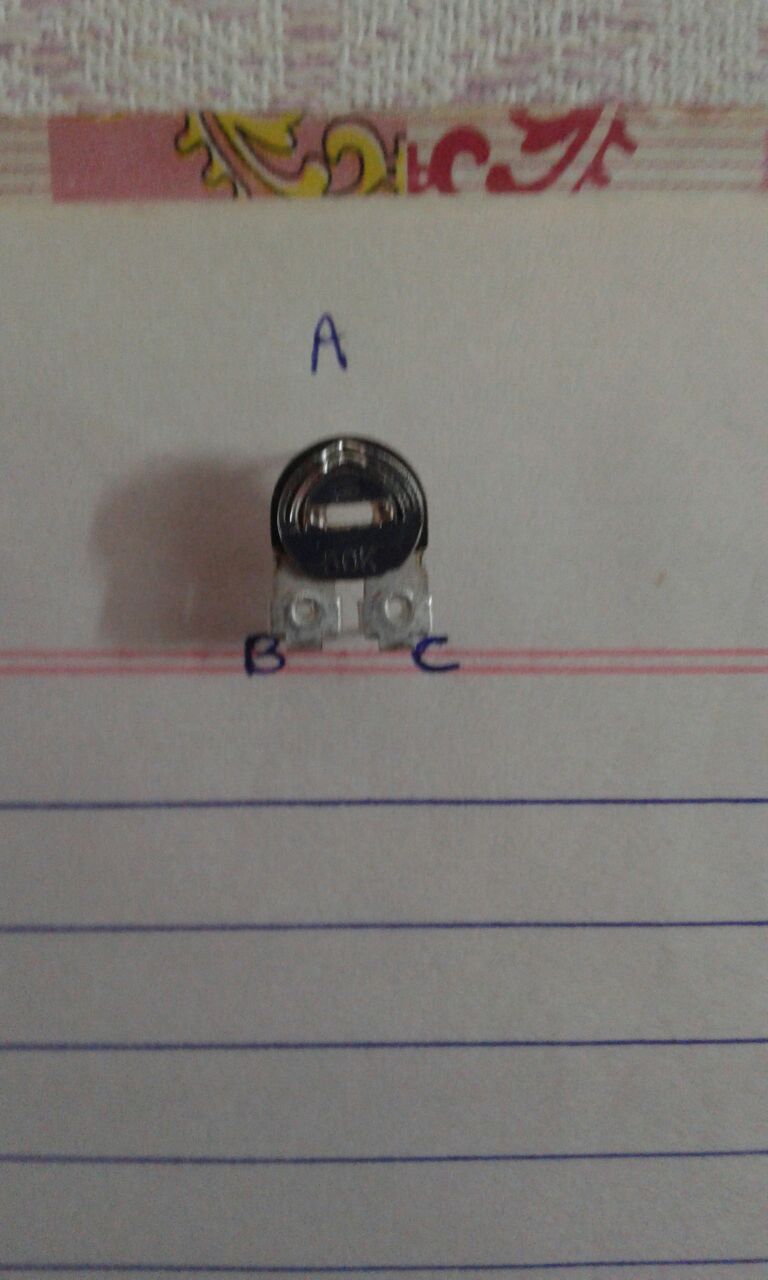

Dear
tell me about this pot.I don't know how to connect it.
