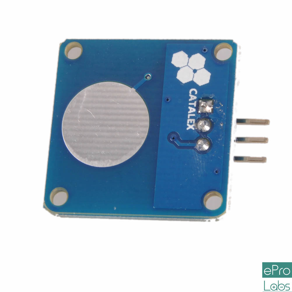

I would really like to know how to make a circuit that consists of 4 LED's that must toggle on/off when the TTP223 capacitive touch sensor is touched. I am trying to perform this task without using a Uno mother board but I am stuck.
I am currently trying to use this sensor
  • SEN-0069.pdf

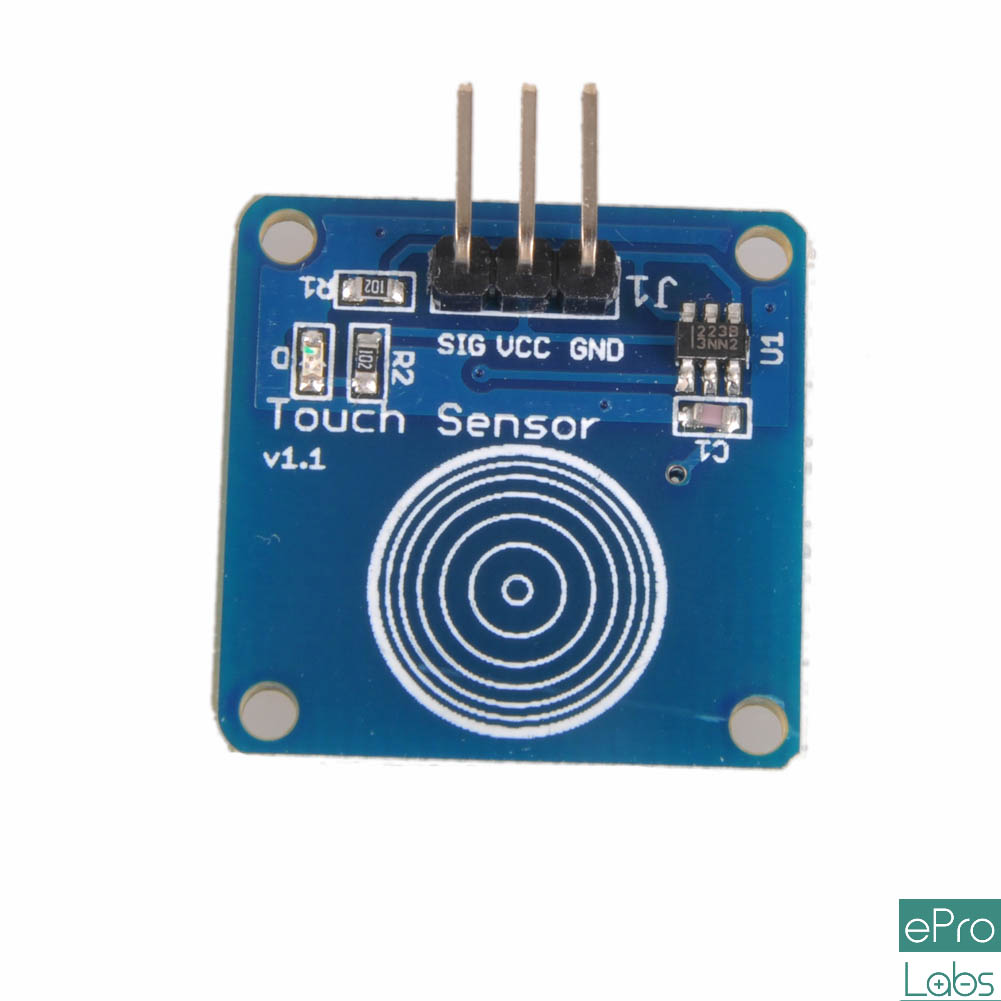

Can not see the image for the type of board, is it the blue one or the red board?
The blue one I've found has LC on the development boards sensor pad.
Or
The red, Touch printed on the sensor pad on the back of the board?
Tho both use a TP223 chip.

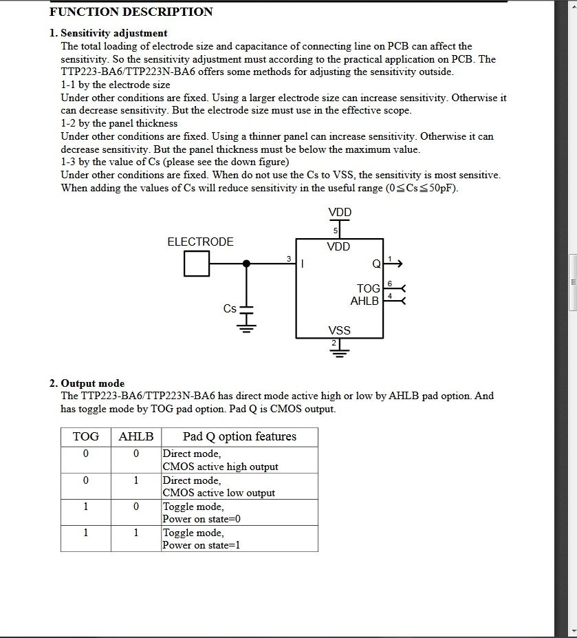

The TTP223 has a pin setting that can set the output to either sourcing when active (switching on)
or low when switching on.
Meaning that the chip is idle (Off) low, then contact is made that sends the output high, sourcing.
OR
Chip is idle (Off) sending a high value close to the power rail input (near VCC) then contact is made that results in the output going low, sinking.

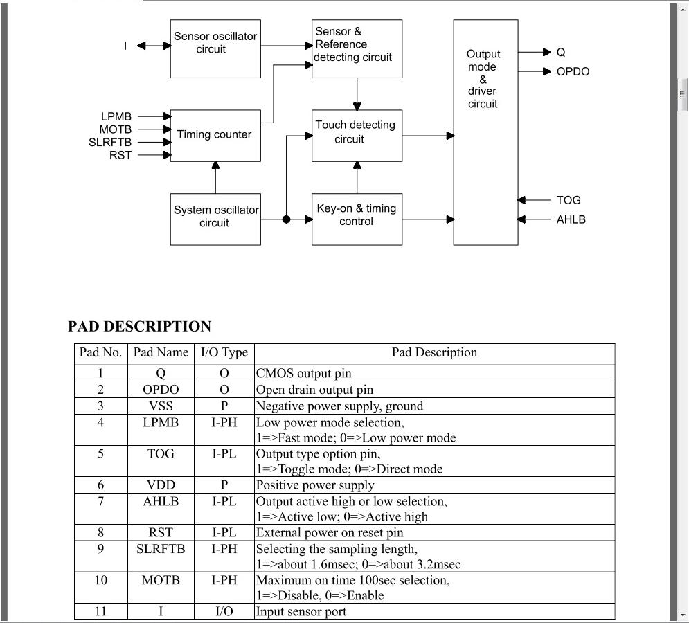

The 2 pins that do this are the TOG and AHLB pins.
These pins also function the Toggle feature. These 2 pins are integrated functions to the IC. They are combination pins.
0= common GND / Low statement.
1= VCC / High statement.
For toggle mode. ther are two options, initiall sink or source.
This mode is for sourcing a device when the chip switches on. Goes from low to high.
Pin TOG connected to VCC, Device total power is less than 5V.
Pin AHLB connected to GND.

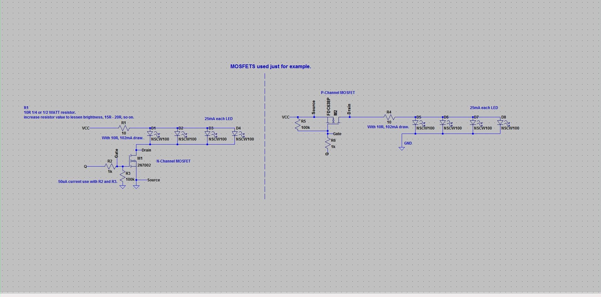

Example, I choose sourcing in order to drive an N channel logic level MOSFET as this devices output is CMOS.
Setting the jumper pins on the board (that should have them) or may have to acquire them.
Pin TOG to VCC and pin AHLB to GND.
The Q pins output through a 1K Ohm resistor to the MOSFETS Gate, and a 100k Ohm pull down resistor at the MOSFETS Gate to power supplies GND point on the TTPP223's board connection point. The N-Channel MOSFET Drain would be connected to the LED's Cathodes wired in parallel with a current limiting resistor connected the the VCC rail. And the MOSFETS Source pin connected to the GND on the TTP223 board. same place as the 100K Ohm resistor.
I am assuming 20 mA each LED? 80 mA total. a standard 2N7002 would function this, reaching up to 200mA potential per MOSFET Transistor,
==================== This device TTP223 is not best suited for driving a BJT. Unless CMOS levels are maintained. LED driving leaves CMOS levels. The Base drive current would need to be high for a total drive only of 2 LED's The TTP223 would be floored at sourcing, sinking could drive only 3 LED via a P-channel BJT. MOSFETS play out better with this TTP223 chip.
