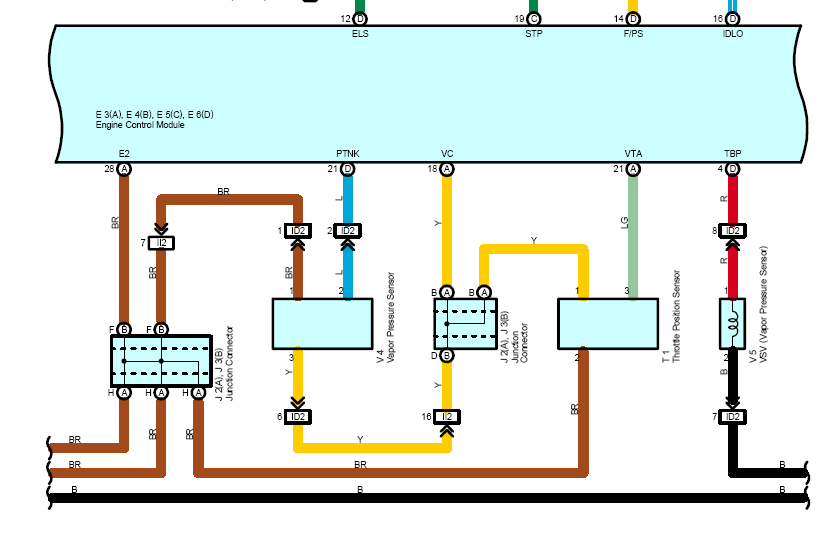

I own a 2006 Corolla, and have been listening to the coverage of Toyota's accelerator recall. I haven't received a recall notice yet, but I expect to. Something about the mechanical fix doesn't seem right to me, and there are folks who have been saying that it could be an Engine Control Module software problem, so I got to thinking about it. The Throttle Position Sensor is a potentiometer built by **broken link removed**
I pulled out the Corolla's wiring diagram to see how the Throttle Position Sensor is wired to the ECM. I was questioning what would happen if one of the wires between the ECM and the Throttle Position Sensor became disconnected? Could that cause the ECM to think that the pedal was all the way to the metal, and cause a "runaway"?
Here is a fragment of a wiring diagram that spans 13 pages. The Throttle Position Sensor is T1, the light blue rectangle in the lower right. The ECM is the big blue mass at the top. What follows is my speculation as to how it functions: If there are any trained Toyota mechanics that can correct my speculation, please chime in...
T1 pin 3 is the wiper of the Throttle Position Sensor pot and it goes to ECM pin VTA. T1 pin 2 is the low side of the pot and goes to ECM pin E2 via the junction block and brown wire. T1 pin 1 is the high side of the pot and goes to ECM pin VC via the junction block and yellow wire.
Interestingly, the pot high side is driven by a pin on the ECM rather than being tied to a source of 12V. Similarly, the pot low side is driven from a pin on the ECM rather than being tied to a ground lug. I'm speculating that this is so the ECM can test for an open Pot or bad connection.
During normal operation, presumably the ECM drives VC high, and drives E2 to ground. That allows the ECM to A/D what comes in on VTA to determine the pedal position. Presumably, during a Power Up test, the ECM can remove power from VC (or switch it to ground) which would cause VTA to go to ground so that the ECM can check half the the connections. By driving Vc high, and turning off E2, that would cause VTA to rise to the max voltage, so the ECM can check the other connections and the pot integrity.
I know that this type of scan is done when the key is first turned on, but is it done continuously during driving?
If the self-test is periodic while driving, say once a second, then if the connection between T1 pin 2 and ECM pin E2 became disconnected, the ECM would know that the High on VTA is caused by a broken wire, not because the pedal was floored. If the self-test only happens once during key-on, then the ECM could think that a broken wire means go fast???
So, does anybody know how often the self-test is done????

Just theorizing here. I would suspect that they don't use the entire range of the POT either. That way, an open leg would put the voltage above the safety trigger point and the ECU would go into fault mode and close the throttle.
Are you sure that the throttle sensor is a potentiometer? Lots of the communication in cars is now serial. My 2001 car has several serial busses as well as the CAN bus and I was always under the impression that the accelerator position was serial.
The VC wire is most likely 5 V regulated rather than 12V. If it was tied to 12 V they would have to allow for fluctuations in the 12 V as well, and it's only a few mA at 5 V.
It would be difficult to test the connections because the VC for the vapour pressure sensor and the throttle sensor are in parallel, so the current would have to be tested quite accurately to detect one of them being disconnected.
However, I guess that all of this is irrelevant to the problem. Just about all stuck throttle problems are mechanical. Just be ready to stamp on the brake, and turn off the ignition if the car takes off. Also, if it is a petrol car, find out what it is like to stop without the power brakes, as the power assistance will fail after a few presses if the throttle is wide open.

In answer to MikeMI, I'm a trained Tech, but not Toyota.
Unfortunately, training, along with troubleshooting procedures, do not really go into the finer details of how a management system performs fault monitoring and reporting. The monitoring and reporting is normally continuous though, resulting in MIL illumination as soon as values meet the criteria to generate a DTC (Diagnostic Trouble Code)
When a DTC is generated, which could cause powertrain damage or become a potential safety issue, normally a 'limp-home' mode is activated, where engine output is reduced.
DTC's are only a pointer toward a potential source of a fault, not a definitive answer and that is where a lot of techs (and others with code-readers) can fall down. The DTC says it's this.....let's change it..
Troubleshooting procedures, when followed to the letter, can sometimes give incorrect results. A DTC which is classed as 'Not Present', usually ends up with the respective ECU being blamed, and replaced, when in actual fact the problem is usually due to intermittent contacts or water ingress to wiring harness connectors. ('Not Present' refers to a DTC which has been generated previously, but the criteria for generating the code is no longer met....These code usually self-delete after X amount of drive cycles without any re-occurence.)

AFAIK, potentiometers are still the predominant means of sensing throttle position. Where three wires and a single pot were previously used, you now normally have six wires and two pots. The pots are normally classed as 'Sensor1' and 'Sensor2', each having a separate supply and ground from the ECM, with the wiper of each also connected to the ECM. I haven't actually measured the pot resistance values, but the voltage signals returned to the ECM are 1:2 (or 2:1). Each pot is fed 5V & ground, the wipers move in tandem, the voltages returned are 0V to 5V on one sensor, 0V to 2.5V on the other.

I stand corrected on the throttle position sensor. I know that the 1994 Fiat Cinquencento had a potentiometer throttle position sensor, but the throttle was opened with a Bowden cable.
The problem in a petrol car with a stuck throttle is that there is no inlet manifold vacuum when the throttle is wide open. It's the inlet manifold vacuum that powers the brake servo.....

The TPS cannot actually cause a runaway anything, only the butterfly valve being physically stuck would do that. The TPS isn't actually used for any full time calculations in the ECM, it's used for short term fuel/timing corrections when you modulate the peddle. The MAP/MAS/MAF sensor, whatever it's using, isn't fast enough to detect if you've just floored the gas pedal and the engine can lean out for a split second while that sensor catches up, so the TPS is used as a quick fuel burst to compensate for that. It's also used for idle detection.
All the important sensor use the ECM's ground and regulated 5V sensor power rather than just any 12v from the regular power harness. You can't get a proper calibrated reading if you don't have a hard reference ground and power.
Agreed. However, if there were to be a hypothetical situation where the pot wiper were able to move, indicating a higher throttle demand than actual, on a modern system the throttle-positioner could be driven to reflect the false demand. Older systems, where both the TPS and bowden cable were directly connected to the butterfly, couldn't suffer from this example.
The TPS is used primarily to indicate demand, in conjunction with MAF and engine temp. Fuelling corrections are adjusted by feedback from upstream O2 sensors, along with engine temp and short-term trim is adjusted accordingly, via fuel injector pulse-width. Ignition timing considerations are monitored and corrected jointly by the Crank Angle Sensor (which also serves as the main engine speed sensor), and the Knock Sensor. TPS & MAF almost mirror each other when the pedal is stamped upon creating WOT. There is a slight dip in MAF when the butterfly snaps open.
Agreed. The important sensors use 5V and actuators can use either 5V or B+. (Or even higher voltages when Peak & Hold Common-rail diesel injectors are concerned)
