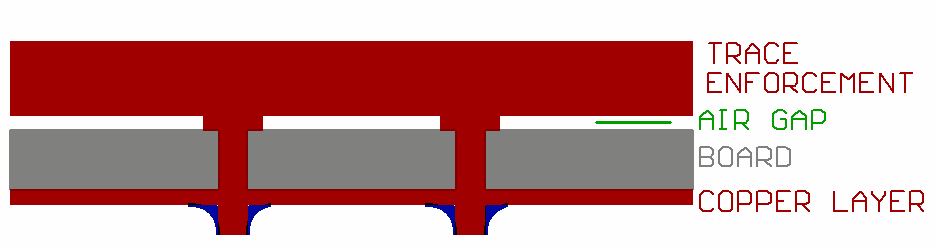

I'm afraid for good reason that your suggested method burries a great safety risk. I saw this technique used in a UPS. Caused by a malfunction close to a short the copper traces got so hot that the solder melted and flew through the enclosure. If it piles up high enough it will cause more trouble.
A better way is using stranded wire pretinned and solder it onto the copper trace.
Soldering tin has a resistance of five times copper resistance.
There are also copper strips availabe looking like cattle fences. They have pins every 1/2 inch which can be soldered to the trace without considerably reducing its cross section. They are mounted on the component side and their distance to the board is big enough (approx 1.5mm) to prevent heating the board in case of overload.
Planning for a PCB with high current flow using PCB material with double copper thickness (standard: 35µm, enforced: 70µm) should be considered.
Additionally this method offers reference measuring points for trouble shooting.

Hi Hero999,
I think it was the lack of a suitable fuse that caused the meltdown more than the technique itself.
Solder does have a higher resistance than copper but the layer is probably five times thicker than the copper trace so it's probably good for double the current.
All your other idea like using stranded wire are good though.
