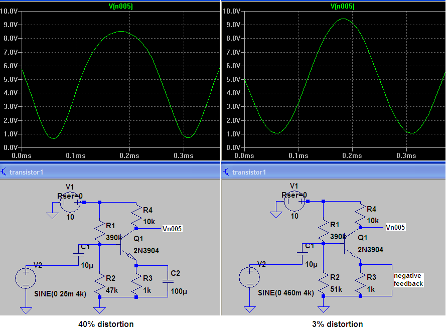

Here is a simulation of a single transistor without negative feedback. its voltage gain is about 190 and its distortion is 40%.
The same amplifier has negative feedback added so that its voltage gain is reduced to 10. Its distortion is reduced to 3%.

audioguru - It seems to me that the distortion comes because the Zout of the source is 4k, and the Zin at 1kHz is only around 50Ω (re of the transistor, plus a drop from the capacitor). But, if the signal source was Zout 1k (easily achievable with an emitter follower), and you add a 55Ω resistor in parallel with the capacitor, the distortion should go away, no? Can you simulate that also?
BTW - great simulation - what software did you use for it?
My simulation and schematic are made with SwCAD III software that is free from Linear Technology.
In my sim the source impedance is zero, that is why the voltage gain of the transistor is so high. The input impedance of the transistor circuit is 6.5k ohms on the datasheet of the 2N3904 but is calculated as 12k ohms.

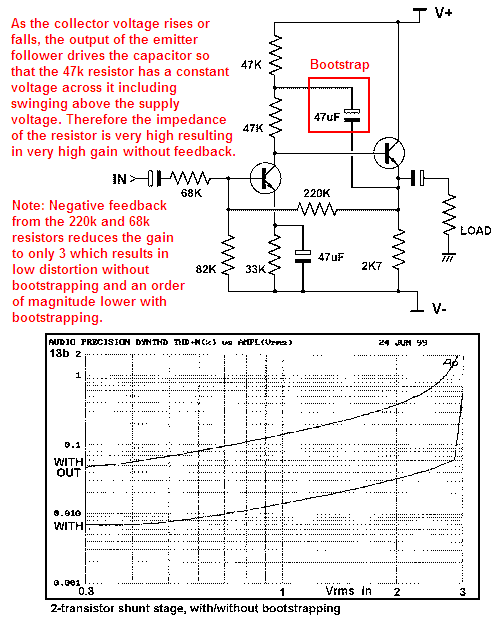

Distortion is reduced if the collector has a constant current source (used in opamps) instead of a resistor that provides less and less current as the output voltage tries to rise. Bootstrapping also reduces distortion but the bootstrapping capacitor needs to be driven from a low impedance emitter-follower.
Zout of the source is zero. 4k is the frequency. The input impedance is beta times re, in parallel with the bias network. The nonlinearity comes from the fact that gain≈Rc/re, and re is dependent on emitter current. Re≈.026/Ie , and Ie varies with instantaneous signal amplitude.
