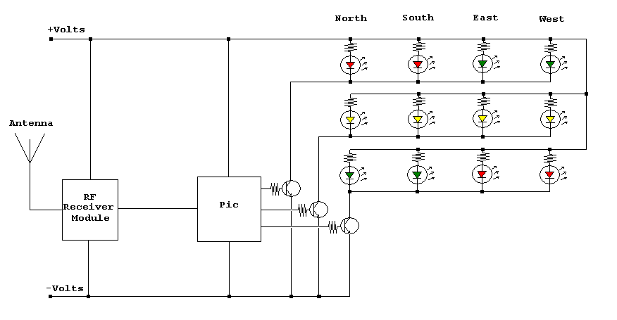

untested:
Here is the most basic Traffic Lights Pic Circuit. (depends on which pic you use, you may have to add a reset switch,or, bla bla bla, for the pic to turn on/function).
Yes, the rf module's output can be connected directly into the pic, as shown.

The circuit posted by Screech would suffice. I don't know why it has an RF receiver. You would not need that part. Also, if you want to add pedestrian lights they would be extra. Note that the PIC can drive one LED directly from each i/o but if you want 2 or more in parallel, then drive them with a transistor as per Screech's circuit.
You will need a 4 MHz crystal and 2 capacitors. I expect Nigel's tutorials will show details.
For the pedestrian push button, connect +5 Volt to the button and the other contact goes to the PIC i/o pin with a 4k7 resistor to gnd.

Don't neglect to connect a 100 nF bypass capacitor across the Vdd and Vss pins.
The diagram posted has all the yellow light on at the same time? I have never seen RED then YELLOW then GREEN.

The circuit will not work right as all the YELLOW leds are tired together, so as you tell the GREEN light people it is YELLOW time and to get ready for RED, the RED light people will see the YELLOW as well. Do not use that curcuit.
So add an I/O pin and move two of the YELLOW LEDs to it and then you can write the code to make it work.
EDIT: Also, when you kill the GREEN light to turn on the YELLOW, the RED light goes out for the other side and might take off. :) Also, I make these comment based on the way the lights work in the US. Maybe they are different elsewhere.
