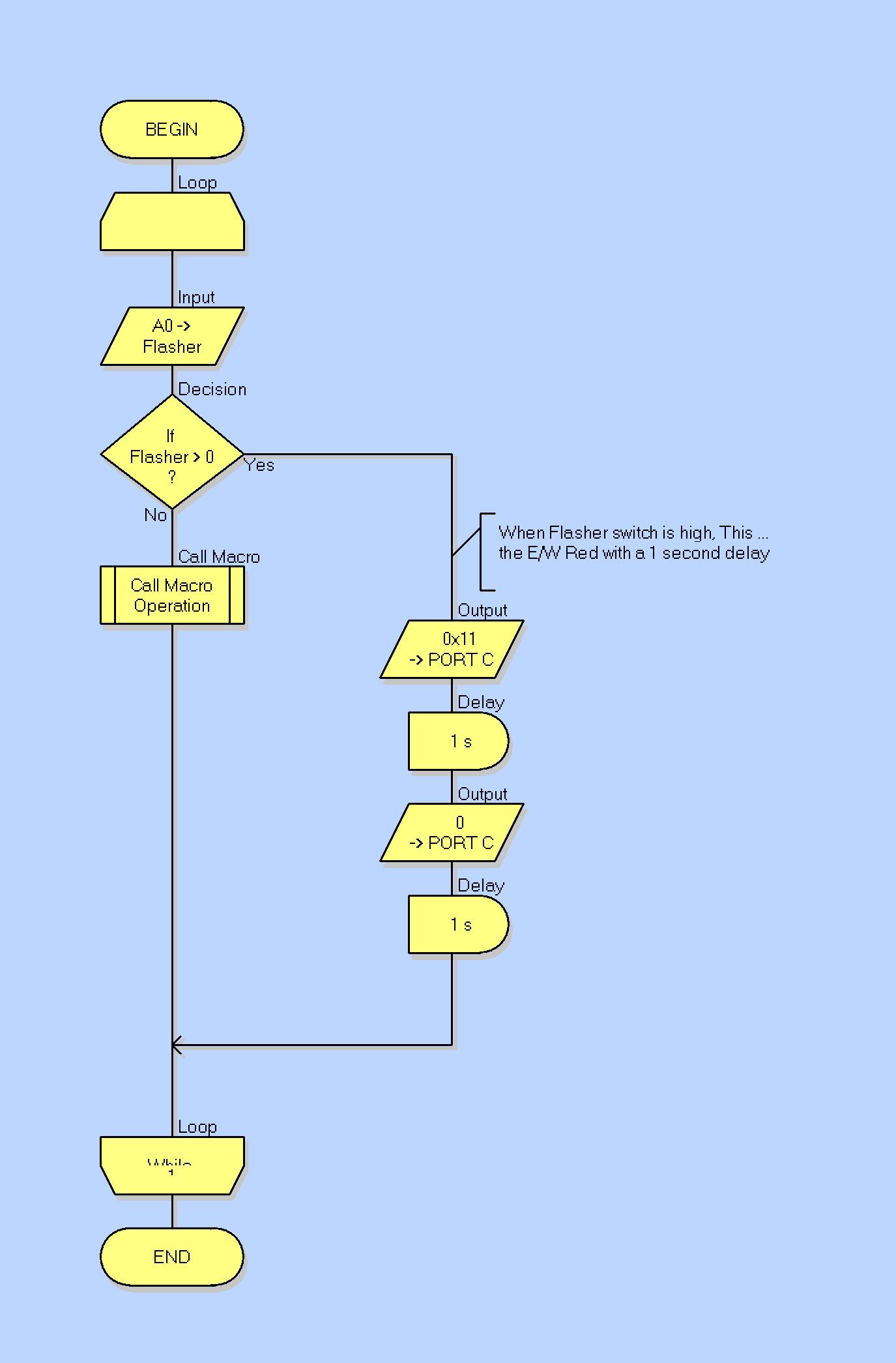

Traffic Lights Program using flowcode
skeeterb
I've been working on this for a while with the help of 3v0 in the chat room, and have gotten this code working. Using a potentiometer or preset you can adjust the timing of this code from 1 second to 60 seconds. The Red/Green timing is calculated using the formula 1+((rslt+1)/17) to determine the timing for the Red to Green change and the Green to Amber is half of the value of the Red to Green variable.
here is the code and the images generated by FlowCode.

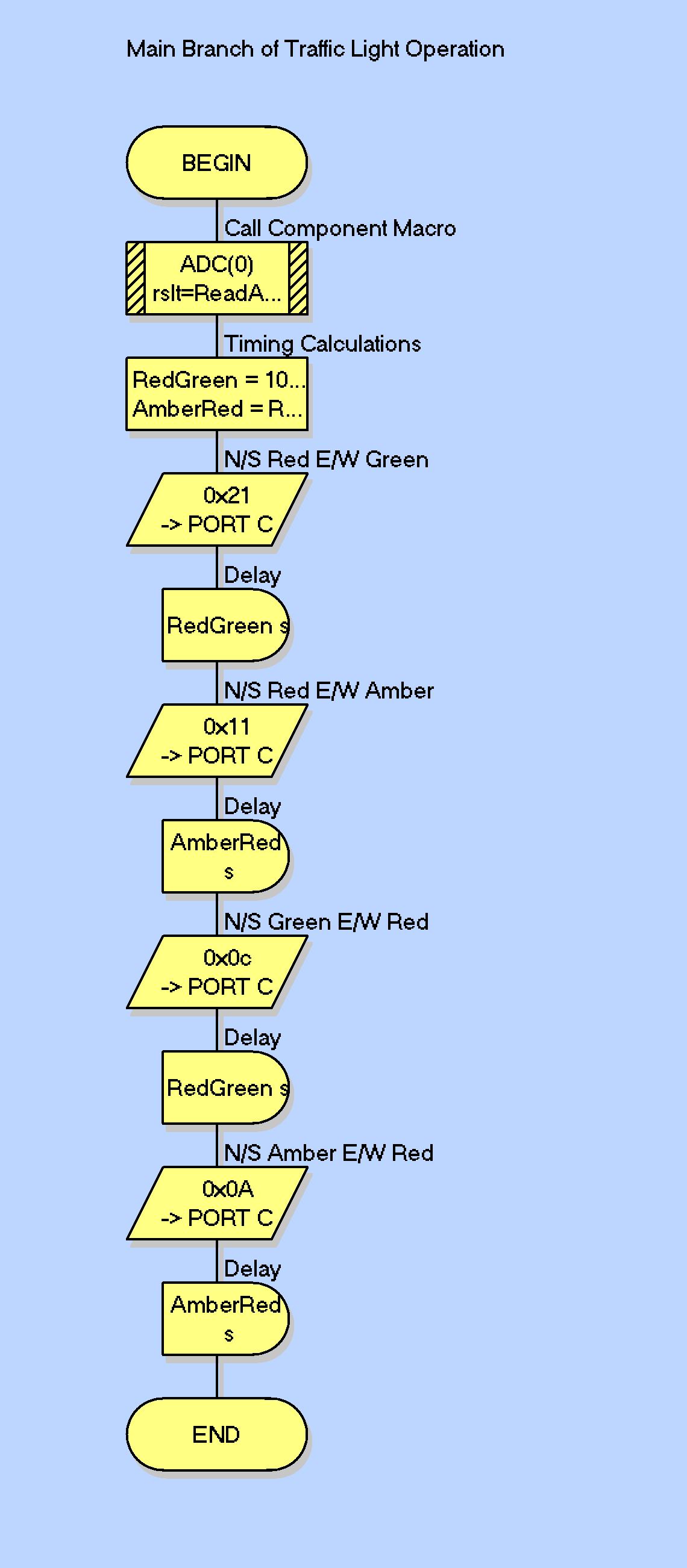

void FCM_Operation()
    //Main Branch of Traffic Light Operation
    //Call Component Macro
    //Call Component Macro: rslt=ADC(0)::ReadAsInt
    FCV_RSLT = FCD_ADC0_ReadAsInt();
    //Timing Calculations
    //Calculation:
    //  RedGreen = 1+((rslt+1)/17)
    //  AmberRed = RedGreen/2
    FCV_REDGREEN = 1+((FCV_RSLT+1)/17);
    FCV_AMBERRED = FCV_REDGREEN/2;
    //Delay
    //Delay: 30 ms
    delay_ms(30);
    //N/S Red E/W Green
    //Output: 0x21 -> PORT C
    trisc = 0x00;
    portc = 0x21;
    //Delay
    //Delay: RedGreen s
    delay_s(FCV_REDGREEN);
    //N/S Red E/W Amber
    //Output: 0x11 -> PORT C
    trisc = 0x00;
    portc = 0x11;
    //Delay
    //Delay: AmberRed s
    delay_s(FCV_AMBERRED);
    //N/S Green E/W Red
    //Output: 0x0c -> PORT C
    trisc = 0x00;
    portc = 0x0c;
    //Delay
    //Delay: RedGreen s
    //N/S Amber E/W Red
    //Output: 0x0A -> PORT C
    trisc = 0x00;
    portc = 0x0A;
    //Delay
    //Delay: AmberRed s
void main()
    //Initialisation
    ansel = 0;
anselh = 0;
    //Interrupt initialisation code
    option_reg = 0xC0;
    //Loop
    //Loop: While 1
    while (1)
        //Input
        //Input: A0 -> Flasher
        trisa = trisa | 0x01;
        FCV_FLASHER = ((porta & 0x01) == 0x01);
        //Decision
        //Decision: Flasher > 0?
        if (FCV_FLASHER > 0)
            //Comment:
            //When Flasher switch is high, This subroutine flashes the N/S Amber and
            //the E/W Red with a 1 second delay
            //Output
            trisc = 0x00;
            portc = 0x11;
            //Delay
            //Delay: 1 s
            delay_s(1);
            //Output
            //Output: 0 -> PORT C
            trisc = 0x00;
            portc = 0;
            //Delay
            //Delay: 1 s
            delay_s(1);
        } else {
            //Call Macro
            //Call Macro: Operation
            FCM_Operation();
        if ((1) == 0) break;
    mainendloop: goto mainendloop;
Good work skeeter, nice to see flowcode working for you. Let's see some action shots too!
I've tweaked the formula to calculate the timing for the delays. The new formula is ((rslt+1)/17). Now it has a 0 to 60 second delay for the Red/Green timing, and half of that for the Amber/Red delay.
here is my new code since I added the left turn signals to my code
    //Output
    trisc = 0x00;
    portc = 0x21;
    //Delay
    //Delay: RedGreen s
    //Output
    trisc = 0x00;
    portc = 0x11;
    //Delay
    //Delay: AmberRed s
    //Output
    //Output: 0x09 -> PORT C
    trisc = 0x00;
    portc = 0x09;
    //Delay
    //Delay: RedGreen s
    //Call Macro
    //Call Macro: LeftTurn
    FCM_LeftTurn();
    //Output
    //Output: 0x0C -> PORT C
    trisc = 0x00;
    portc = 0x0C;
    //Delay
    //Delay: RedGreen s
    //Output
    trisc = 0x00;
    portc = 0x0A;
    //Delay
    //Delay: AmberRed s
    //Output
    trisc = 0x00;
    portc = 0x09;
    //Calculation
    //Calculation:
    //  Timeout = 1
    FCV_TIMEOUT = 1;
    //Delay
    //Delay: RedGreen s
    //Call Macro
    FCM_LeftTurn();

void main()
    //Initialisation
    ansel = 0;
anselh = 0;
    option_reg = 0xC0;
    //Loop
    //Loop: While 1
    while (1)
        //Calculation
        //Calculation:
        //  RedGreen = ((rslt+1)/17)
        FCV_REDGREEN = ((FCV_RSLT+1)/17);
        //Input
        //Decision
            //Comment:
            //Output
            trisc = 0x00;
            portc = 0x11;
            //Delay
            //Delay: 1 s
            delay_s(1);
            //Output
            trisc = 0x00;
            portc = 0;
            //Delay
            //Delay: 1 s
            delay_s(1);
        } else {
            //Call Macro
            FCM_Operation();
