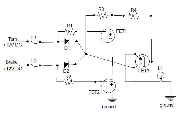

I was encouraged to see a post here that would help me combine the brake signal with the turn signal on my tow
vehicle so that it outputs to a common 4 prong plug, but ChrisP's post from May 2004 has a broken link
to his circuit. Darn. The situation is exactly as he describes. This just combines the brake and turn funcitons
into one bulb. It is a logical XOR gate.
I came up with the attached design by piecing together various sources and ideas, and I think it is good in
concept, but when it comes to actually picking the components and connecting them on a breadboard, that is
where I am having difficulty. For some reason, although my simple circuit has only 9 components, controllers
like this sell for $35 to $200 and have a boatload of stuff in them. Of course the store bought ones work
and mine doesn't...LOL
In this diagram, only half the total is shown; it would be duplicated for the left turn, and the running light wiring
doesn't need to be a part of it at all.
I don't have a good grasp of exactly the difference between MOSFETS and BiPolar transistors, and I don't think I know for sure the difference between n and p channel components either.
I am not sure I understand why MOSFETs have source/drain/gate and why bipolar transistors have base/collector/emitter.
I read a post by Roff who once suggested using a p channel in a 12 volt controller when it is desired to put
the load between the circuit and the ground. That is how it wants to be for trailer lights: the ground is always
there and it is the +12v that gets switched.
Here are the values that I chose:
R1 = R2 = R3 = 33K ohm 1/4 watt 5% resistor
R4 = 10K ohm 1/4 watt 5% resistor
D1 = D2 = 3 amp 400 PIV rectifier diode #276-1144
F1 = F2 = 5 amp quick blow fuse
L1 = #1156 trailer light bulb draws 1.5 amp
FET1 = FET2 = n channel 60 volt MOSFET IRF510 Power #276-2072
FET3 = TIP42 Transistor 65watt PNP silicon #276-2027
You may ask "why is R4 there?" Becasue my first attempt at building this used the same FET3 as the others, and it
smoked when I applied the brake. I might have had the source and drain mixed up though. So I changed FET3 to a
p-channel at Roff's suggestion to someone else, and threw another resistor in there to burn off some of the gate
voltage? I don't know what I am doing.
The second time around, which is how it is currenly drawn and specified, blew F1 when the signal was applied. Do I
have the source and drain mixed up on FET1 and FET2? I would be surprised that would blow a fuse.
I thank anyone who can give me some advice on this.

I haven't analyzed your circuit beyond noticing that your FETs are upside down. The Drain and source need to be interchanged, otherwise the body diode is always forward biased...
No you didn't, you changed it to a PNP BJT.
I'm all for your experimentation and interest, but you need to read a few books and get a foundation in all of this. Your experimenting could get expensive and cause damage to not only your transistors but also your car.
Thanks MikeMI for confirming my suspicion. In round 3 of my trials I did swap the drain and source feeds for FET1 and FET2. I had always visualized electricity as flowing from positive to negative, but I realize now that isn't really what happens. Electrons move from negative to positive, from ground to the battery. So the symbology used for a diode seems inconsistent to me because it's arrow points from positive to negative. The arrow in a FET points from negative to positive. See what I've learned already... I am so proud of myself.
Thanks ke5frf, I learned that I used the wrong term, bi-polar transistor. Apparently people refer to these as BJT or Bi-Junction Transistors. It seems to me that either way, it should still fall under the umbrella of Field Effect Transistors, but I am wrong. It is more like a bi-junction-diode, but they do say BJT, so I'll pipe down about semantics.
So here is the results of round 3:
Nothing. No blown fuse, no light, no smoke, nada.

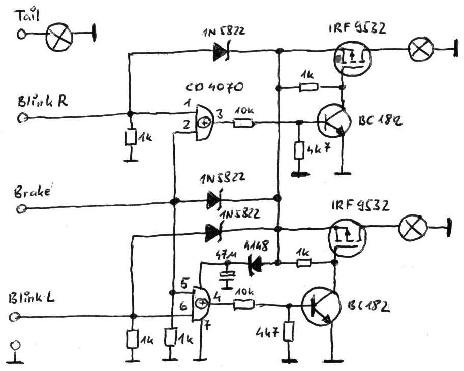

I looked at what john1 posted on March 20, 2003; it seems his circuit simply dims the running lights so that the brakes add to their brightness when activated. I don't accept that as a solution.
Sebi's post from March 19, 2003 looks like what I need, but I have a hard time reading it. I think he used a 1K ohm resistor between the input and the ground to be sure it is low if it isn't high. Maybe when only one of the inputs is high, the other one isn't really low, but rather undefined.
His diode is a 1N5822 whereas I used 1N5404. It looks like the specs on the one I used, an easily obtained one from Radio Shack, has higher values across the board. That is probably not the problem.
He used an IRF9532 p channel MOSFET whereas I used a IRF510. Hmmm. That looks a lot different. It doesn't look like Radio Shack has anything like it.
He also used an IC, CD4070 to do the xor function. That will be difficult to obtain also. I think that if I can find a place to get these items, I'll just build what Sebi designed.

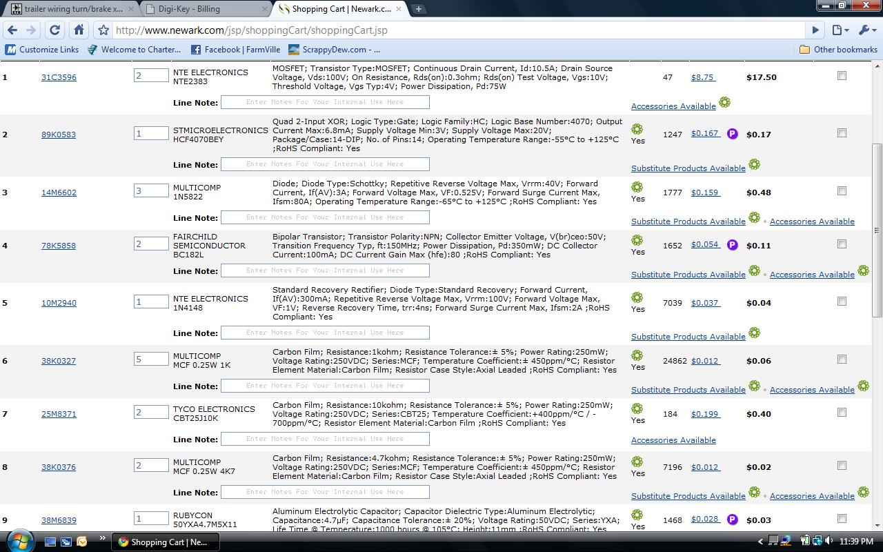

Your suggestion to use Newark for a parts supplier is a good one. They were the only one of the three you mentioned that
had all nine parts I need. I was really surprised at the cost of the p-channel MOSFET. $8.75 are you kidding? It wasn't
even the one that Sebi designed. Apparently his 2003 design uses obsolete parts. I also had a hard time reading
his hungarian handwriting. A friend I know who works at a motor controller company said that "4k7" means "4.7K"
...and those europeans cross their 7's, but I knew that from a trip I took to France once.
I am attaching a list of the parts that I ultimately chose. What do you think?
Thanks for your time and assistance, your internet acquaintance, Andy
OK, I looked over your bill of materials and a few things you should be aware of.
The HC logic series IC you picked for the XOR function is rated for 85degC maximum recommended serivice (HCF). That should be plenty, but being in an automotive circuit exposed to outdoor operating temperatures in a circuit with load currents over an ampere, I might have considered the HCC version. Under normal operating conditions this shouldn't be a big deal, 100 F is only 38 C for reference...plus the load is indirect in the circuit, but robustness is always a good idea in automotive applications. Also be aware that the HC family is a progression in design from the old 74 series TTLs. Your CD 4xxx series was an intermediate CMOS chip, and the HC series was designed for better CMOS-TTL compatability. I wouldn't think you'll have any issues here with driving the NPN from the XOR, or setting the XOR inputs high/low with your signals, but be aware that you are driving a BJT from a CMOS product.
Also, go into this fully aware that this is a hand drawn schematic you plucked off of an internet chatroom. It may be super-duper and I see no reason why it shouldn't be.
Oh, one very important note. I don't know how your last project was set up, but be aware that your FETs need to be adequately sinked.
Take note that your BC182 transistor (TO-92) has inconsistant pin configurations. Pin numbers aren't specified in the hand drawn schematic, so this is a good example of knowing the orientation of your B-E-C pins for your particular transistor. Be very careful with datasheets, all of the characters in the part# are significant.
Project Update:
I got the parts that I ordered from Newark.com. They were good; I would recommend them as a supply place. I designed an arrangement of the circuit so that it could be made on a single sided PCB with no jumpers. I tried half (because it is a mirror image kind of logic circuit, one for the left and one for the right) of it on my breadboard with success, and I was delighted.
Then I built the whole thing on a 25 x 15 hole board from Radio Shack. I had a hard time dragging solder along my designed traces, and so I used jumpers on the backside anyway. When tested, I found that only half of the circuit worked. I decided that I probably got one of the BJT BC182's too hot during the soldering, so I went down to R/S and got a BJT 2N3904 to replace it. Like you said, the base and collector pins are swapped, so that made it akward to put onto my board which was designed for the european transistor; but it went in with a careful twist.
Upon another test, I found that the circuit does work on both sides, but the one side that did not work before now works poorly. Instead of completely interrupting the brake input for the signal input, it just dims the bulb a little bit. The other half is perfect. So I figure there must be some slight value differences in the currents and potentials through the substitute transistor that are leading the MOSFET to act like an amplifier rather than in it's desired full saturation switch mode. I tested every component both ways with my multimeter and got substantially similar results in every case. For example, one pair of test points might read 4.68K ohms on one half of the circuit and 4.72K ohms on the other half. I figure that is within allowable range of deviation. Also, the tests across the BJT's were consistent when I set the multimeter to diode testing mode.
My next experiment will be to change and maybe improve Sebi's design as follows:
1) Tie pins 8,9,12,&13 (the unused inputs to the quad XOR gate) to Vdd. I think that unused inputs should not float lest they affect the proper operation of the remaining gate?
2) Add three more 1N4148 diodes to the inputs of the IC. The specifications say that Vi is best if it = Vdd, although a Vdd +0.5V is allowed. Adding these diodes will bring Vi down to Vdd since Vdd goes through a diode.
