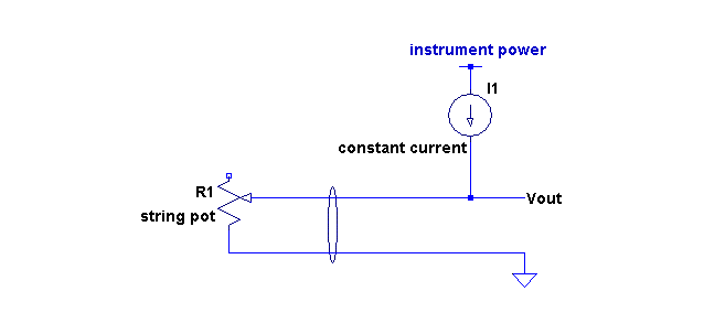

Below is a possible two wire implementation. The biggest potential problem I see is that wire and wiper resistance are in series with the actual resistance to be measured. These can prpbably be calibrated out.
