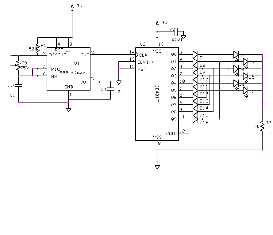

Yeah thats what I am kinda after the knight rider effect but I got the schematic from this arron cake website I don't know anything ablut what component goes where. I really want to learn but due to chemotherapy and agressive medications I am reaaly week so I have no time to sit and learn about elecrtonics I am just hoping I can take a design like that and turn it into a circuit board so I can etch it, I have some practice in etching.

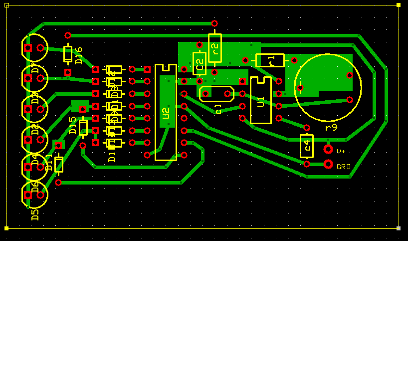

Knight Rider circuit and PCboard
Here is a Knight Rider circuit with a 555 timer. Depending on how fast you want it to run, the resistor, capacitor values may need to be changed.
this board is about 3.25" x 2"
We don't need no auto routing.
If you download express pcb (free down load) ten I can send you the files or you can learn from the files.
NOTE the board can afford some more tweeking and add filled planes to save on etching time etc.
As for etching, I prefer the muratic acid/hydrogen peroxide method.
Oh that would be greatly appreciated is there a way you can get more LED like double that (12). That circuit looks easier then the one I found, thank you so much.
You can add another 4017 or more then you will have more LEDs. If you added more to the one 4017 then you would need a transistor per LED as the 4017 would not be able to handle more than 20ma per output.

Do you feel confident in etching a double sided board. Much easier to lay out.
Actually I never did a double sided board. I just messed around with the single sided ones. Well putting the design together and laying it out will be kind of a challenge cause I don't know anything about 4017's and what they do and where they go so for that part I am lost :(
