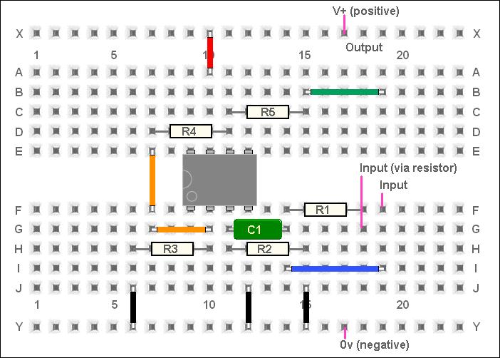

I am VERY new to this, I found a project that I want to try but I am not sure hoe to go about transferring my schematic to a breadboard. Could somebody please help me out?!?
Here is a link to the schematic: **broken link removed**
I dont really learn by reading either, so here is a link to a breadboard: **broken link removed**
THANK YOU!

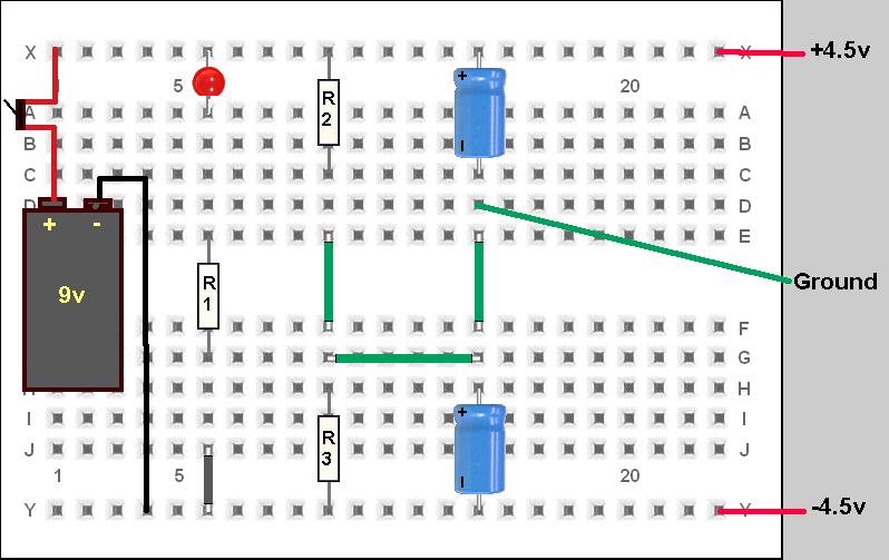

Here is one way of doing it.
Note, R2 and R3 could just go straight to the lower power rail saving the outside two black jump wires, I did it this way for clarity.

Here is one way of doing it....y.
Elegant diagram. What did you use to make it?
I would suggest the addition of a Vdd to Vss Bypass Capacitor across the pins of the chip.
Thanks. I used the second link in the first post. Then I edited it slightly using a generic photo editing type prog'.
Indeed, a bypass cap would be a good idea, I just 'breadboarded' the schematic given.

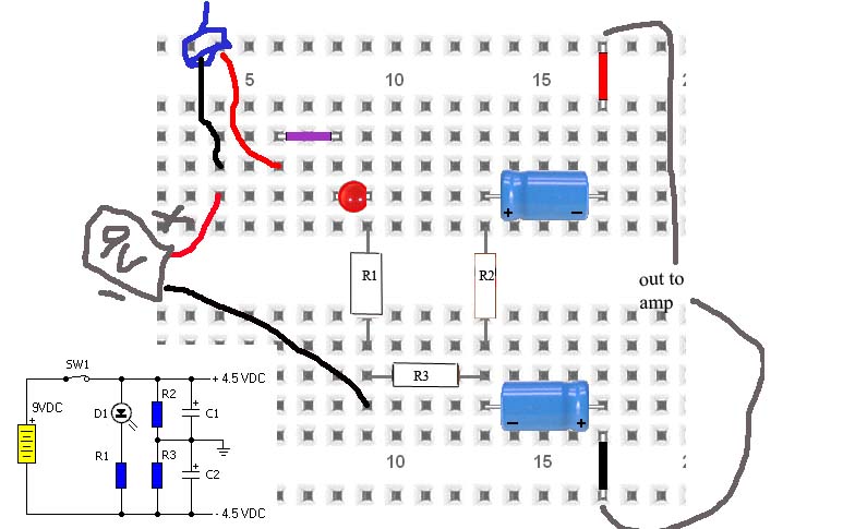

OK! after checking out the schematic for the amp itself and figuring that out, I think I have the Battery supply figured out, any feedback would be appreciated!
*note, the blue thing is the switch and the gray thing is the battery itself, please excuse the drawing

The way you have your design, the LED would light, but that's all. Also, one of your capacitors was reversed. I have made a schematic of your design and a breadboard diagram of how it should be.

Thanks for your help, I kind of figured out where I was running into some trouble as well, I have a breadboard, but mine doesn't have the two outside rails, for the + and -
