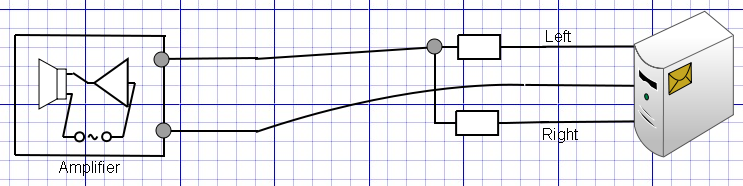

Hello. I need safely transform PC stereo audio output to mono. After signal going to one-channel self made amplifier. Now i'm listening only right channel. Show schematics please.
You should be able to just use a Y cable to combine the two outputs into a single input. The PC output drivers should be able to handle a little extraneous voltage from the other channel without damage.
If you want a little protection, include a 10Ω resister in series with each output.

Why i can't do like that?
scheme0001250000-png.51788
And it is not harmful for PC's output? It is VIA board, so i do not want hurt it.
The LINE OUT on most sound cards has a 100Ω resistor between the output amplifer and the jack, so it is ok to short the Left Channel to the Right Channel to create a mono signal.
Generally, with things like MP3 players, IPODs, etc that are designed to drive headphones, it is not OK to short the Left and Right channels without using series resistors.
