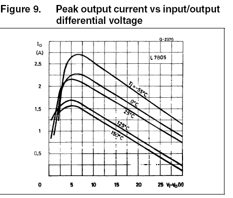

I know 7805 regulator can deliver max 1.5A.
Be careful with that. Some 7805's can deliver 1.5A and others only 1.0A. Check the datasheet to be sure.
It is better to leave some headroom in all designs, so I would find a regualtor that is rated to run at 2A or more. The 7805 will not always be able to deliver it's max current rating under all conditions:
7805-png.21831
Example datasheet. (Yours will be different):
https://www.st.com/stonline/products/literature/ds/2143/l7805.pdf

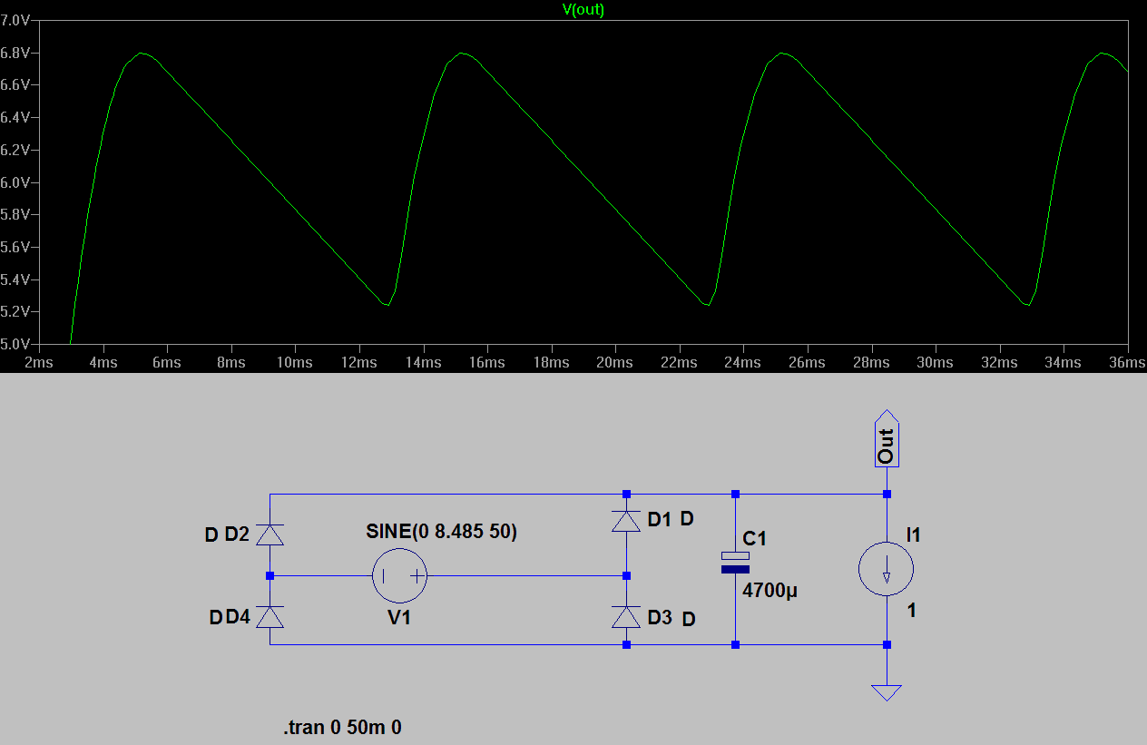

I intend to use a 6V 18VA 3A toroidal, after rectify i get about 8.4V @3A
That isn't enough, you've forgotten to acound for the voltage drop in the rectifiers (between 1.4V to 2.2V depending on the load) and the ripple. This will give 7.4V to 6.2V, minus say 1V ripple which isn't enough to ensure the regulator regulates properly.
Us a 9V transformer and a 16V 4700µF filter capacitor across the bridge rectifier and it should work perfectly.
I don't get it one say is enough a 6V AC one say is not :confused:
With 6V AC i get 8.4V DC after rectify, how could i get 6.2 volts?
So to know, it's not a problem that my trafo have a current of 3A even if this regulator can max 1.5A, right?
As I've just said, you haven't taken into account for the loss in the rectifier. Each diode will drop a minimum of 0.6V and a maximum of 1.1V and in a bridge rectifier the current passes through two diodes per cycle giving a total loss or 1.2V to 2.2V.
There will also be some voltage ripple on the capacitor which will reduce the useful voltage further as the voltage needs to always be above 7.5V for the regulator to work properly.
LTSpice says the peak is 6.8V and the troff is 5.2V which is far too low for the LM7805 to regulate properly - see attachment.
If the voltage is increased to 9VAC then the ripple will be between 9.4V and 11V which is more than enough, in fact with a 9V transformer, you could reduce the capacitor to 3300µF with no problems.
