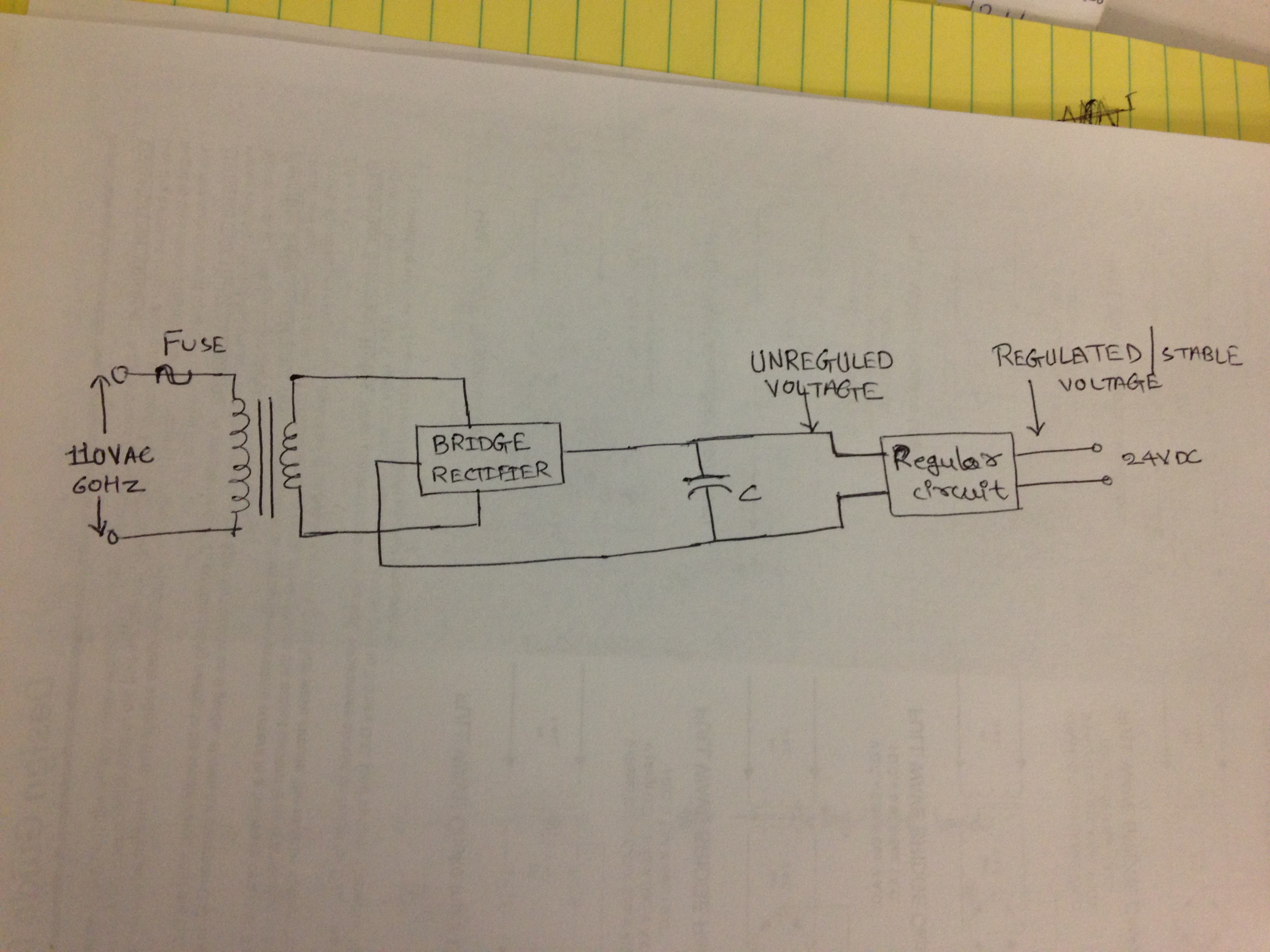

Do you have a design that you're intending to implement? Can you post a schematic?
Ken

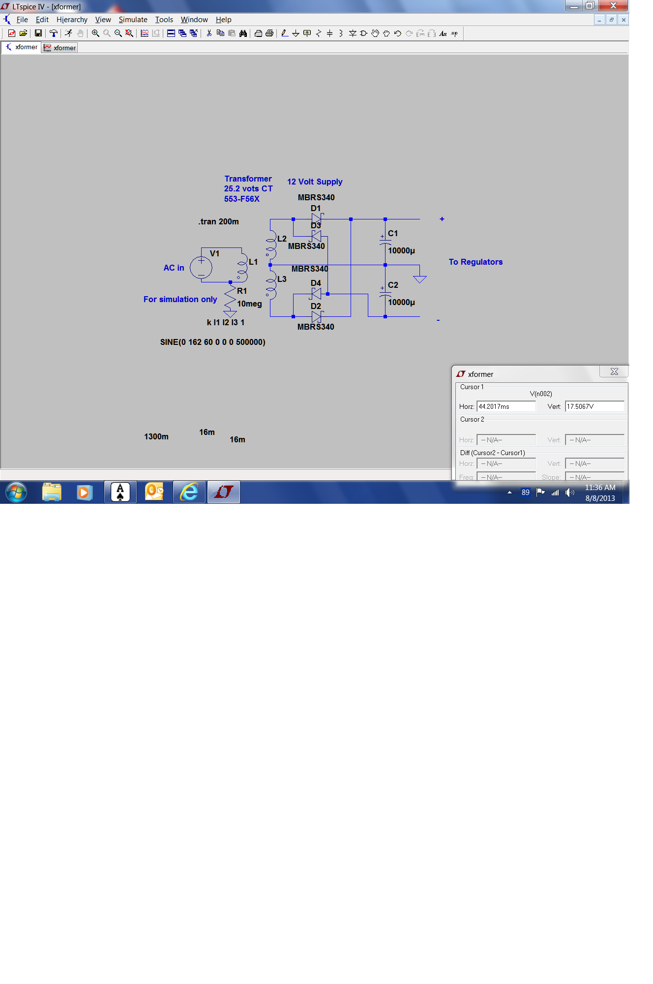

Easy is a bit more expensive, while cheap is hard. So take a look at this transformer and the attached circuit. We can add the regulators if it looks ok to you. (easy one):D
https://www.mouser.com/ProductDetai...ha2pyFaduhrVUM3P3AW%2bNGCy7bpe0dB0sRLod32h7A=

Pretty much any transformer rated for 105-120VAC/60Hz primary, and a secondary rated at 24VAC/2A (or greater A) or 24VAC CT/2A (or greater A) or Dual 12VAC/2A (or greater A) will work. Any bridge rectifier or for diodes rated at higher than 1.4 x 24V and a current higher than ~4A. Now, if you are going to add a 24V or two 12V regulators you will need secondary voltages of greater than 24VAC. Say about 28VAC.

Can you explain me how did you calculate ratings for diodes/rectifier? (I got that rectifier should be 4A (higher than my current which is 2A.)
Since you want +/_ supplies it is easiest to use a center tap transformer. The transformer current needs to be higher than your load because of the diodes and the capacitor that has to be charged - so 2.8 amps. It will get hot at full load.
The voltage needs to be high enough that with the filter caps the voltage stays high enough so that there is room for the voltage drop across the diodes and the regulator that follows. So in your case the caps will charge to the peak voltage (17.8 volts) then discharge down to about 15.4 volts because of the load. A smaller capacitor will let the voltage fall further a bigger one less.
The diodes need to be able to handle the maximum current on a continuous basis and the peaks needed to charge the cap. I think I used 3 amp diodes. I used schottky diodes because the are more efficient. They need to withstand the maximum voltage which in your case is about 36 volts - so the ones I used may be a little low at 40 volts - a 50 or 75 volt one would be better.
