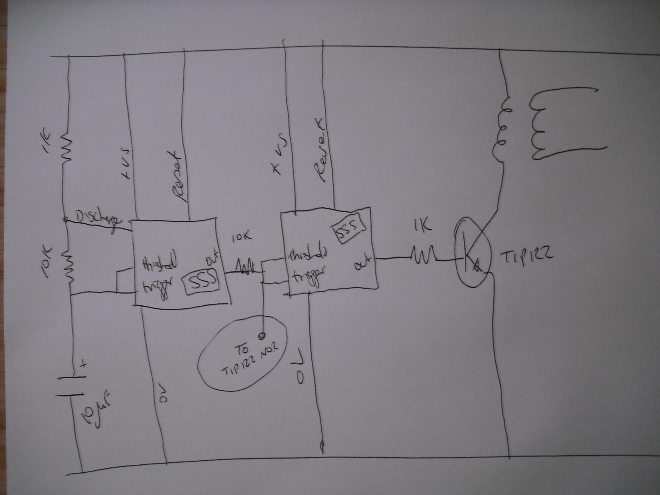

Yes, large change in voltage. Can you tell me how you're driving the transformer's secondary? Can you post a drawing. I have a hunch that you're using a transistor and turning it on and off. That will create a VERY large spike. NO, I don't have any equations. It all depends on how fast your driving element ( transistor? ) turns off.
yeah transistor switching see diagram below, and both the transistors go to a centretap now.
its wierd when i use straight battery on the transformer it produces 3mm long sparks, but using the transistors, no sparks. i think it has to do with the amount of current the transitors can supply. or maybe hysteresis in the transformer is smoothing out the output voltage from the secondary?
there you go

What you've built is a "flyback" circuit. When you driving transistor is on, current quickly builds in the transformer primary. When it it suddenly switched off, the field around the primary coil suddenly collapses, and huge voltage spikes results. This can fry all your electronics and power supply if you don't do something about it ( now, ask me why I know that :) ) You might try a snubber across your coil's primary to provide a path to slowly discharge the overcurrent. At a minimum, it can include a reversed biased doide connected across the primary terminals.

Actually, V is proportional to di/dt, the rate of change in the current. The proportionality factor is the inductance.
The high voltage spike actually occurs when you remove the 12V supply from the primary, as BrownOut has stated.

yeah back EMF, i think that is one of my problems. im using d cell batteries to go through tip122 which can switch 8 amps. this goes into a 150ma 12,12 ctap transformer. now im trying to make an inverter, i havent measureed the current from the secondary but im pretty sure its bugger all.. i assume the back EMF is stopping sufficient current from flowing through the primary. that is i doubt the full 8 amps is flowing. so i figured that ill just need a higher voltage to increase the current flow, but then ill get a higher voltage out of the secondary which i dont want, and ill hit the maximum voltage for the transitors too ( im already using 12v). so what do you do to get good current output from the secondary? ive looked at other peoples shematics and they basically are doing what im doing. 12 into a 12v 240v transformer
I think you're getting off-track. You only want enough current to flow to give you the 240V ( or whatever ) you need. Flowing more current will solve no problem, but will give you more output voltage. You control current by the transistor's "ON" time. The longer the transistor is left on, the more current flowing, and visa-versa. Using a diode in the primary will help to keep down the secondary voltage as well.
