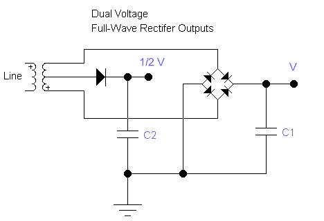

Here's a diode connection for a center-tapped secondary transformer that gives you ½V and V outputs. Although it may not be apparent, both outputs are full-wave rectified. The center tap output uses the two bridge rectifiers to ground as the return for the ½V full-wave rectification.
NOTE: The center-tap must be at the 1/2 voltage point for this configuration to work properly.

You don't need a diode at the ½V tap.
You are correct. Good observation. The two bridge rectifiers act like a full-wave rectifier to the center-tap but the output is taken from the center tap, rather than from the diodes, as is normally done.
Nice spot Hero :)

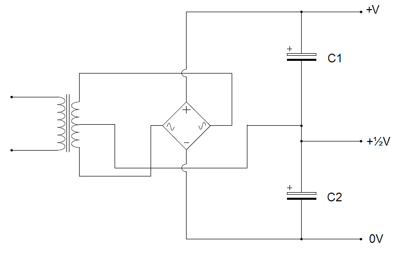

Although with small loads the diode is not needed, further simulations showed that the diode minimizes interaction between the two output loads. At higher loads without the diode, some of the ripple from the bridge output appears at the 1/2 tap output.
That will probably improve if you make C1 equal to C2 and connect them in series and connect the centre tap where they join, as you would with a bipolar power supply.
Where does the centre tap go other than to circuit common, which is where the capacitors are already connected?
With the transformer disconnected from power, measure the resistance between the brown and yellow leads. If you get an open circuit, then you have separate windings. If you get current flow, then it's taps on a single winding.
I mean like this.
I mean like this.
That would give ripple and noise at the ½V output equal to one-half of that at the V output, so it's not clear how much that configuration helps. It also halves the filter capacitance for the V output for a given capacitor size. But it will likely be acceptable for many applications.
