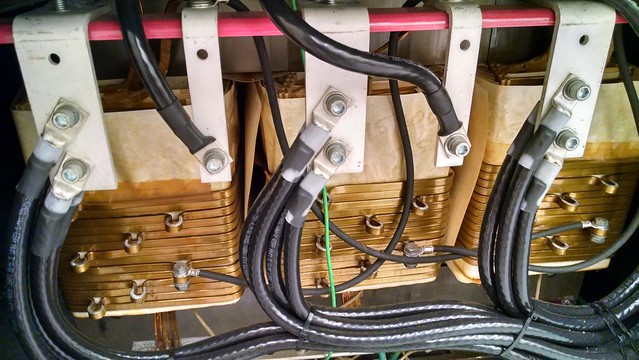

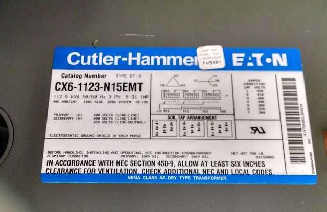

Good information Eric.
Larger transformers usually have a 'percentage impedance' (voltage drop on full load due to the winding resistance and leakage reactance ) that's used to calculated short circuit currents.
I'm replacing this transformer (chinese power) with one designed for a US delta power feed so I would like to
match the 'percentage impedance' for electrical safety reasons from the main panel to equipment feed.
