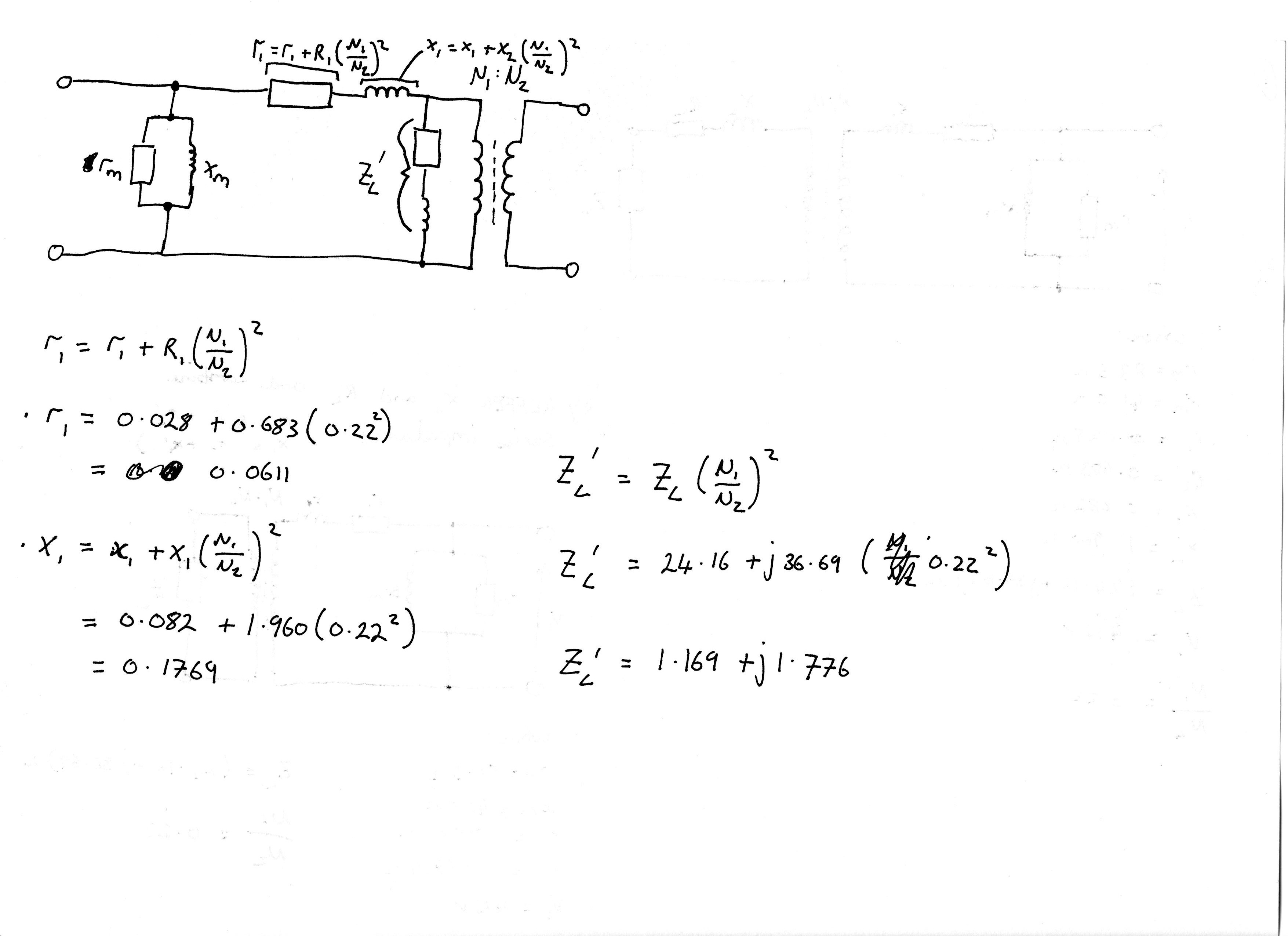

I've attached a quick graphic of the work I've done, I hope it helps.
I can understand referring the load impedance across, but then in my head at the moment don't get how you would use that.

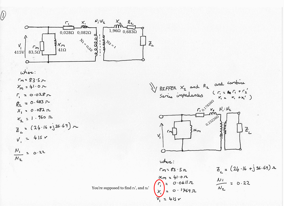

Hi. The values you get is wrong. You shall find r1' and x1'.
I upload a copy of your drawing where I have added some text and the values for r1' and x1' that I think is right.
When that is done, you should also set up a help circuit where you also refer to a Zl' to get the primary current.

Hello Grossel and RCinFLA,
I've uploaded a clearer image (I hope) showing what I've done. I've now referred the load impedance Zl and I think I've done this correct, and I know (I think) that the voltage across the load in this configuration relates to the secondary voltage via the turns ratio squared??
so I need to use a bit of circuit theory to find the V2 voltage, once I know this, put it back to the secondary side via the turns ratio, then use ohms law across the impedance to find the secondary current.
does that sound right??
Any help is most appreciated.
Cheers,
Owen.

Hello,
Last night I think I had a break through, but I feel my method still might need to be checked..
I took the referred Load impedance, and added it the impedances of r1 and x1 ( (0.0611 +J0.1769) + (1.169 +J1.776) = (1.2301 +J1.9529) )
I found the current going through this new combined impedance using ohms law, with V1 = (415 + J0)
This makes I2' = (415 + J0) / (1.2301 + J1.9529) which is equal to (95.8324 -J152.1428)
I then found the magnitude of this, then using the turns ratio found the current I2 = 39.558 amps, then ohms law to get V1 (V = 39.558 ×(√24.16² + √36.69²) = 1737.79 Volts) This number is less than my no-load voltage, but in the same region so I feel confident with that, but I'm not 100% confident with that.......
I think I've managed to get the Primary Current, and Power factor as well.
I1 = I0 + I2'
(I0 comes from the no load test from finding I0a and I0r)
(4.970 - J10.122) + (95.8324 - J152.1428) = (100.8024 - J162.2648)
finding the magnitude of this gives 191.02 Amps, (which feels like a concern, thats a lot!!)
Putting the I1 phasor into polar gives 191.0262< -58.1506
Cos(-58.1506) gives a power factor of 0.528 lagging.
Sorry for so much maths, I need reassurance I've done the right thing... and if there are any mistakes along the way, showing the steps I've done someone can pinpoint the issue quicker.
Thank You for all your help so far.
Owen.
