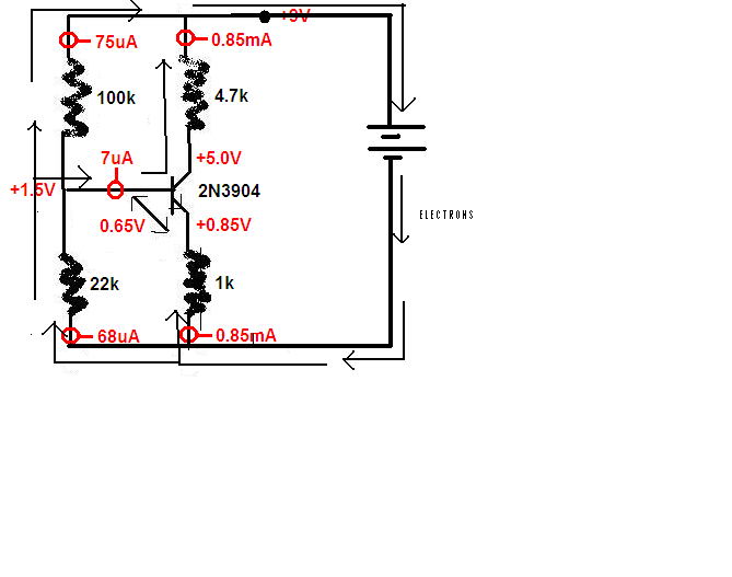

I calculated some resistors for your transistor circuit. I used a 9V supply.
1) The voltage divider tries to supply +1.62V to the base of the transistor but the 7uA of base current reduces the divider's voltage to +1.5V.

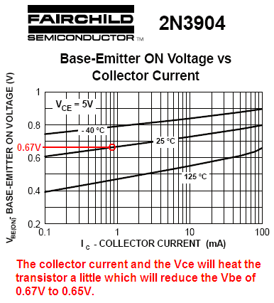

2) The datasheet of the transistor shows that its base-emitter voltage is 0.65V when the collector current is 0.85mA.
3) 1.5V - 0.65V= 0.85V which is the emitter voltage.
4) The collector current is almost the same as the emitter current which is 0.85V/1k= 0.85mA.
5) The collector resistor has a voltage drop of 0.85mA x 4.7k= 4.0V then the collector voltage is 9V - 4V= +5V.

super explanation ur a genius who can understand my feelings very well
still i some more doubts here that i have mentioned below
1) could u explain it entire circuit in terms of electron movement i.e how the voltage drops in each component in terms of electron flow
2)1) The voltage divider tries to supply +1.62V to the base of the transistor but the 7uA of base current reduces the divider's voltage to +1.5V.
u r telling that the voltage 9v gets dropped to 1.62 after crossing 100k and that the base current 7ua is dropping it further to 1.5v how does this happen also
till now u have not biased the emitter base then where did u get that base current(also the base current u r referring to is it electron movement of conventional?)

u r telling that the voltage 9v gets dropped to 1.62 after crossing 100k and that the base current 7ua is dropping it further to 1.5v how does this happen?
The 7uA of base current adds 7uA to the 100k resistor so its voltage drop increases to 7.5V.
The base-emitter junction is a forward-biased diode with a voltage of 0.65V and it conducts current as shown in the datasheet.
i cant understand what u mean by this
u have shown 75uA comes to 100K with a energy or voltage of 9v
it itself drops 7.5 volts and has 1.5 volts how did that 1.62v come from also from where did that .65v which forward biases the EB come from come from
but u have marked .85 volts for the emitter
i can understand better if u show the directions of electron flow because i want to know only about reality and not conventional
are u explaining the ciruit in terms of electron movement or conventional?
could u plz mark how the electrons flow in the circuit diagram that u have posted
It does not matter which way the electrons flow. The base of the transistor has 7uA of current and the collector and emitter have 0.85mA of current.

If the base current is not there then the 100k and 22k voltage divider produce a current of 73.8uA and a voltage of +1.62V. The 7uA of base current adds a little to the 100k and is subtracted a little from the 22k resulting in +1.5V at the base of the transistor.
The datasheet for every transistor shows its base-emitter voltage at various collector currents. It is 0.65V for the 2N3904 transistor when its collector current is 0.85mA.
The 1.5V at the base minus the Vbe of 0.65 equals +0.85V at the emitter.

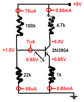

The direction of the current does not matter. The transistor base needs current and it amplifies the current producing a higher current at the collector.

use Ohm's Law:
a) the resistors are a 100k and a 22k for a total of 122k.
b) 9V/122k is a current of 73.8uA.
c) 73.8uA in the 22k resistor produces 1.62V.
d) For the base voltage to be +1.5V then the 100k resistor has (9V - 1.5V)/100k= 75uA in it. the base of the transistor takes 7uA and the 22k resistor takes 68uA.

use Ohm's Law:

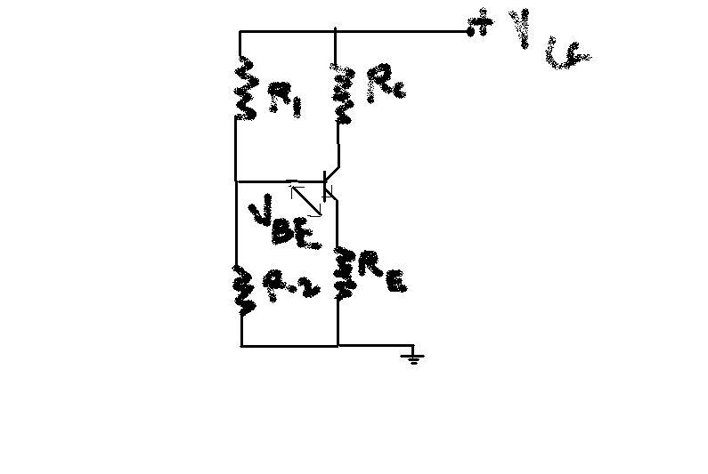

u have only mentioned these values
see for R1 current flowing is 75uA
for R2 u have mentioned 68uA
then u r saying series
series means same current must flow but u have shown different currents

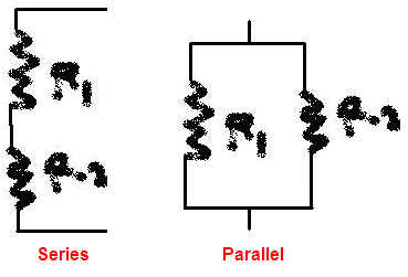

how did u add up the resistors just like that
they are in parallel
You are completely wrong and do not know the basics of electronics.
The base bias resistors are in series so their resistances simply add.
Yes the resistors are in series. But the base-emitter junction of the transistor is parallel to R2.
So the 68uA in R2 plus the base current of 7uA add to make the 75uA current in R1.
