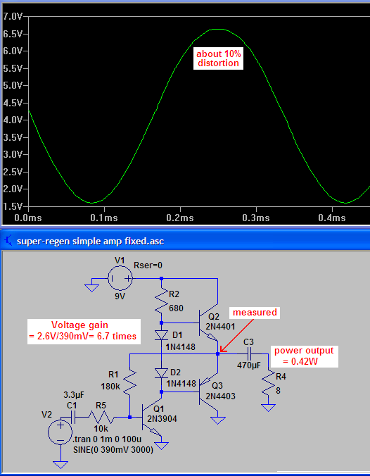

Hello again,
I want to make a amplifier using transistor, now it should have loud sound then earlier circuit given by Audio Guru and i don't want to add ready made chip in it....!!

The extremely simple amplifier I posted will be loud only if you hold the speaker to your ear because its output power is very low at only 0.42W like a cheap clock radio. With a 12V supply the output will be a little more but then the small output transistors might melt.
The simple amplifier sounds pretty bad with about 10% distortion when it plays its loudest.

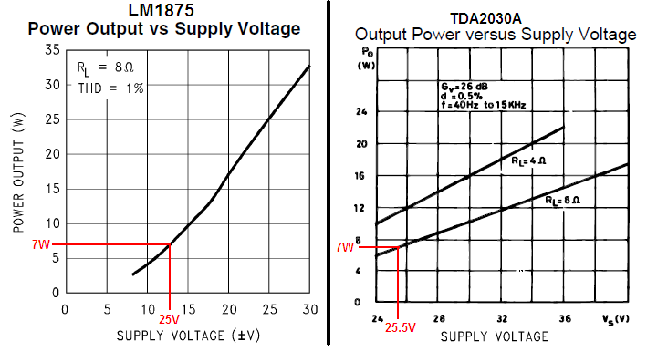

OK, 5-7 watt amplifier.
7W into 8 ohms is a voltage swing of 21.2V. A simple amplifier will have a peak to peak voltage loss of about 5V so the amplifier will need a supply of 26VDC. If you use a 4 ohm speaker then the supply must be 20VDC. If you use a 4 ohm speaker and make a bridged amplifier then the supply must be about 12.5VDC.
Hello, AG how you have calculated the supply voltages?
I used simple arithmatic.
A signal that is a sine-wave and produces 7W into 8 ohms has an RMS voltage of the root of ( 7 x 8)= 7.48V. Its peak-to-peak voltage is 7.48V x (2pi) which is 21.2V. A simple class-AB amplifier has about 5V of losses so the supply must be 21.2V + 5V= 26.2V.
I double-checked with the datasheets of two power amplifier ICs.
