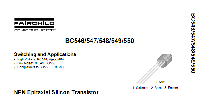

Basically I am building a circuit but one of the transistors I have (BC547) did not come with the leg arrangement labelled. I have checked online data sheets but each one has says something different. I have a digital multimeter at home with sockets for transistor legs labelled E, B, C.
Is there an easy way using the meter that I can check to see what leg is what please?

Who is the manufacturer of your BC547.?? its a 'logo' on the device.
Hi I bought it from Maplin but couldn't see a manufacturer logo on it. I would like to make sure using the multimeter because I've been having problems with the circuit and this transistor plays a key role in doing what I want to achieve.
