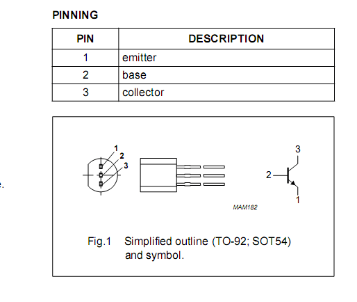

transistor pin assignment
The picture shows you exactly which pin is which.
i'm sorry smanches but what picture?
This one from the datasheet,
Pins pointing towards you, flat to your left,:)

The pic is on the datasheet. Your attachment is for a spec sheet, but you can click on the bluehighlighted data sheet.
Yes, look at the actual datasheet, not just that web page.
oh guys i'm very sorry spec sheet lol.
thank you i see it now.

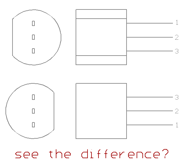

A picture says more than 1,000 words.
Boncuk
Looking at the flat side with the pins pointing down:
Most European transistors are C B E like this one.
Most American transistors are E B C.
Oriental transistors are both ways.
