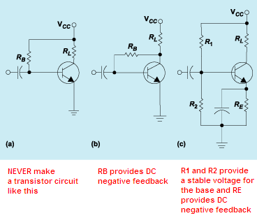

By the way consider the pic 'a' at the bellow link, while bothe base and collector conections are connected to positive surce so why the base-collector connection is biased? the pic bellow seems differnt than when we connect 2 sources to E-C and B-C to describe the bihavior of a transistor.
The base to emitter voltage of a transistor is only about 0.7V. The collector voltage is usually set at half the supply voltage which is much higher than the base voltage.

Thanks for your input and your comment on the pic.
So we just bias the base connection because of base-emitter connection, right?
I mean we just supply the base to turn the emitter's diode on, and then the current will follow into collector? Am I right?

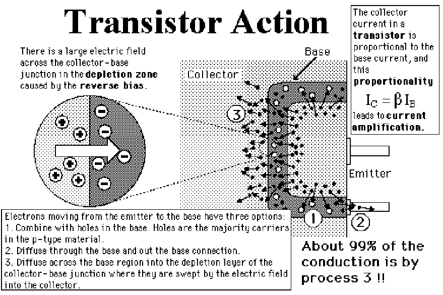

In an NPN transistor operating in the active region, the emitter-base junction
is forward biased, and electrons are injected into the base region. Because the
base is narrow, most of these electrons will diffuse into the reverse-biased
base-collector junction and be swept into the collector; perhaps one-hundredth
of the electrons will recombine in the base, which is the dominant mechanism in
the base current. By controlling the number of electrons that can leave the
base, the number of electrons entering the collector can be controlled.

Yea I have read that. but the question is why when the B-C biase is at its reverse bias the electrons follow through emitter into collector?
is that because the emitter and collector are both 'N' on a NPN transistor or 'p' on a PNP one?
