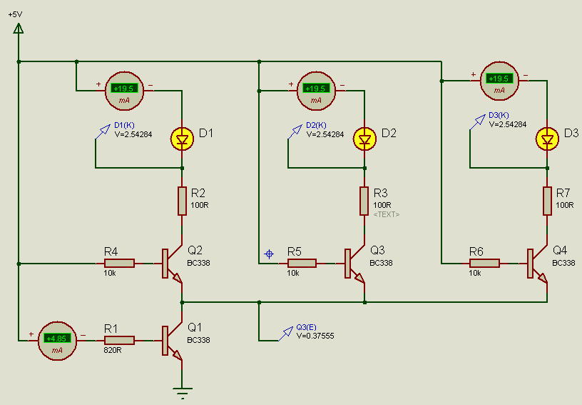

I have started a project using a micro controller to control a LED display and I am having trouble using transistors to switch the LEDs, I have 5 LEDs in parallel being switched by one transistor and each LED is individually switched by another transistor.
I have given each LED its own resistor and the problem I am having is that when all LEDs are on each LED gets dimmer then if only one was on. I don't really understand why this is happening but I'm not 100% comfortable with transistors and I have probably done something stupid.
I have attached a image of how I have wired it up but with only two LEDs.
Any help would be greatly appreciated, Thanks.

The bottom tranistor must conduct fully to have the follow on transistors (emitters) pulled to ground as far as possible.
Use an 820Ω base resistor for the bottom transistor for a full base current of 5mA. With this base resistor value you'll get the collector voltage down to 0.3755 with minor increase with the number of transistors connected.
With a base resistor of 10KΩ the collector voltage is 0.886V, just enough to have one LED bright.
Decreasing the values of the base resistors of the LED switching transistors will increase the collector voltage of the bottom transistor, thus reducing LED brightness.
Here is the schematic for three LEDs, all at full brightness of 19.5mA. Reducing the base resistance further will not decrease collector voltage, since the transistor is fully saturated already.

I think the bottom transistor should be given enough base drive (current) as the collector current it has to carry is summation of all 5 individual collector currents in worst case.
Lower the base resistor to 5V / [(20mAx5)/hFEmin] ... per data sheet hFEmin=100
This comes out to be '5000', you may try R <= 4.7kohm

No.
The datasheet for this transistor and for almost every other transistor shows the max saturation voltage loss when the base current is 1/10th the collector current. hFE is not used for a saturated transistor.
hFE is used only when there is plenty of collector to emitter voltage for a linear amplifying transistor.
So the base current should be 10mA for a collector current of 100mA and the base current should be 20mA if the lower transistor has a collector current of 200mA.

The collector to emitter voltage of a transistor that has a base current that is 1/10th the collector current is typically 0.13V (2N4401 transistor with a collector current of 150mA) but is 0.4V max.
The base-emitter voltage is about 0.7V.

Hi camlv,
as I already suggested use a base resistor of 820Ω for the bottom transistor. The transistor draws less than 5mA with that resistor and shouldn't be a problem for the I/O of your MCU.
With three transistors and LEDs (each 20mA) the Emitter-Collector voltage is 0.37V while with a 10KΩ base resistor it is 0.886V, increasing with each transistor you connect in series with it.
You could also use a small N-channel MosFet (BS170) as bottom transistor. There the voltage loss is about 120mV for your application.
Please observe the LED forward current. With a saturated bottom resistor it exceeds 20mA with a current limiting resistor of 80Ω.
