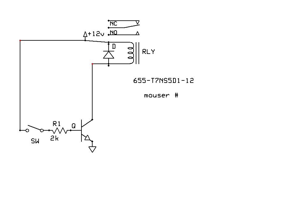

hello everyone...i very new at electronics, and i would just like to ask if its possible to have a circuit switched by a transistor that would normaly be closed. and when a current flows to the base the circuit woul open. the input power would be 5 amps 12v. i realy need your help for a project. thank you

here is a basic 12 volt coil/400 ohm being switched by a 2n2222 transistor.

wire the DPDT relay so when the transistor is enerigized the relay contacts are open and visa versa.
based on info this is it.
