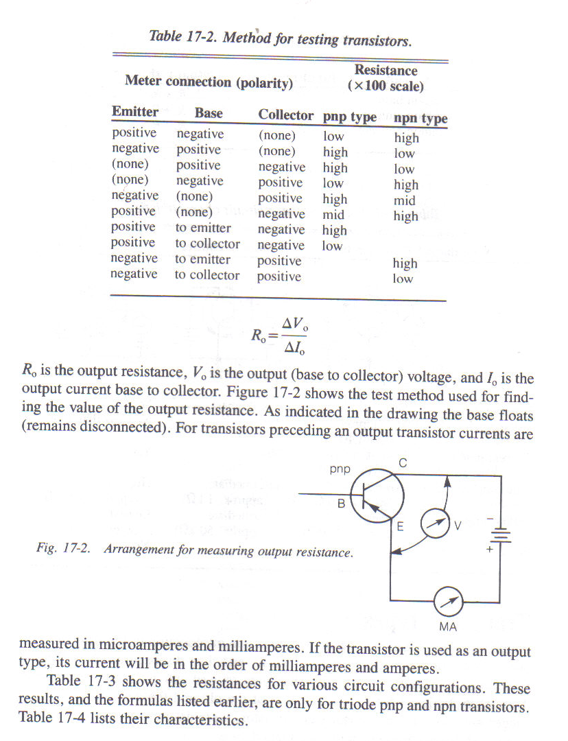

hi i am new to electronics and i want to learn electronics very well, so my first question is how to test a transistor? I know absolutely nothing about electronics!. Help me
The first and most useful thing is to look at the transistor-diode equivalent test. A bipolar transistor will look like two diodes in the following configuration:
So use the diode setting on your meter. With the black lead on the base of a PNP, you should see about .7V on the Emitter and Collector. Then reverse the two leads and it should read open both ways. For an NPN, use the red (+) lead on the base to see the .7V.
Read the number off the transistor and use the internet to find out what kind it is, and where the base, emitter and collector leads are located.
thanx Duffy, and are you talking about testing a transistor that is working in a powered circuit(a biased transistor?)? If so can you tell me how to test another transistor that is not powered (not biased) or not connected into a circuit?
This IS for testing a transistor that is not wired into anything. You have a multimeter, right? See that diode symbol on there? That's the setting you want to use. Touch the test leads together and it should read "0" (or "Shrt"). Open should blink a number, or read "OPn". On a good diode, or these transistors, it will read about "0.7".
Perhaps this image will make the testing clearer.

so if i tested an NPN from "B" to "E" and "B" to "C", then does it show the "0.7" in both ways? I have just tested a Bc548 transistor from base to emitter and base to collector, and it shows "760" in diode test, and shows nothing when test from E to C and reverse. Can u pls tell me what does it mean?
That means the transistor is good.
Yes, it's reading 760 mv, or .76V, so it's fine.

okey, so what reading may i read on the multimeter if i tested a transistor that is burnt? I mean what is the result for a bad transistor?
if a transistor is burnt out then either it is blown open and never conducts or it is melted and is shorted.
You can read bipolars this way, power and otherwise, but not fet's. Are you interested in building something?
