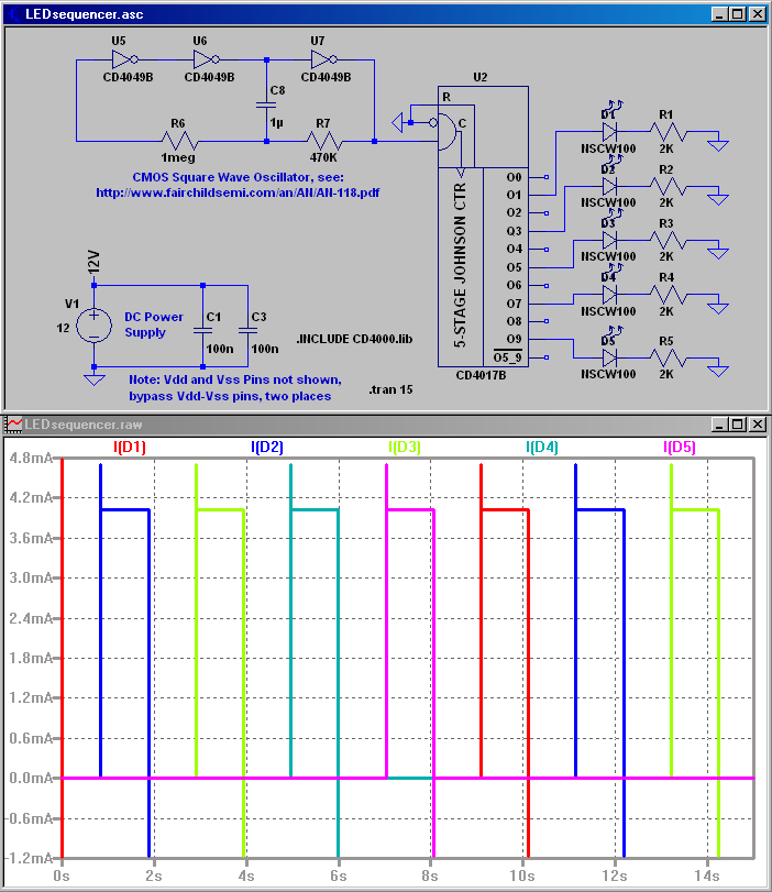

I am trying to build a simple delayed turn on for a sequence of leds.
The schematic I am including is just the first stage but I already have questions.
The object is to turn on a series of leds each one after the first with a short delay between each. The delay goal is around 0.1 to 1second (I will determine proper delay experimentally).
So far I've only used transistors as amps in the linear range or as a switch, but not as any type of delay. The circuit I build i was experimenting with as shown to delay the turn on. The turn on speed was not great but it doesn't have to be. I would like it to be quick enough turn on so that you can't see the led turn on slowly.
What should I do to get a delayed turn on that I'm looking for? Oh and while I say this It might be suggested that I use a 555 or something, but I plan to have many of these delay things so 555s would just be too much.
ty

Each Led will turn on and stay on with the half second or so delay between each. Will probably use 5 LEDs. I was going to add a 6th stage that instead of turning on a LED, it would reset the sequence (free run while switched on).
As far as the microprocessor goes, I did consider, but I only know C++ and C# languages at close to amateur level. So didn't want to play with that idea yet.
Use a 4017 CMOS decoded decade counter. Hook up outputs 1,3,5,7,&, 9 to 5ea. LED/resistors. A single clock oscillator (555?) to advance the counter. This will naturally give equal on and off times as it steps between LEDs. It will recycle automatically. If you're using high-current LEDs, you will have to add a Hex Buffer or five transistors...
