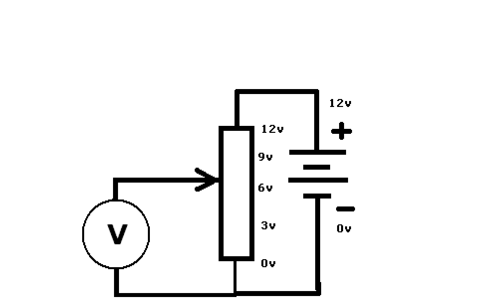

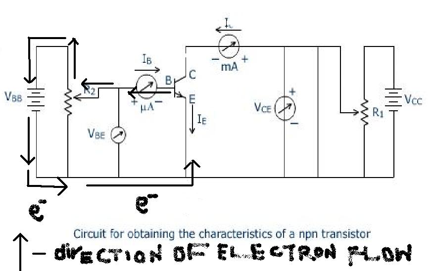

i have a basic doubt in the figure that i have posted
NOTE THE WORD CURRENT MENTIONED BY ME IS ELECTRON FLOW AND NOT CONVENTIONAL
in the figure how does the potentiometer vary the voltage
If u use potentiometer u can vary the voltage drops.This is valid only if u draw current from the battery
but for transistor only the battery's electric field is used there
i cant understand how a potentiometer can vary the electric field of the battery acting on the transistor.
i know how potentiometer works i learnt from this site
but thats valid only in the figure that i have posted which has rheostat and voltmeter
but in the transistor figure the current from the negative terminal flows directly to the emitter and does not flow through the rheostat
then in that case how can the potential be varied because the electrons from the negative terminal are not at all flowing through the rheostat

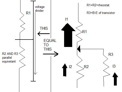

Yes current does flow through the rheotat.
You have over simplified things.
See my modified version of your diagram, I1 = I2 + I3

The rheotat DOES DROP THE VOLTAGE. Get a proper understanding of simple resistive voltage dividers before trying to understand transistors.
2)also where will that I2 end up after it passes through the rheostat
It combines with I3 and flows back to the battery as I1.

when the pot is turned up so its output voltage is 0.6v then the base-emitter of the transistor is forward-biased and begins to conduct current. If the pot is turned up more then the base current increases but the base voltage barely becomes higher than about 0.7V.
The current gain of the transistor causes a collector to emitter current that is a few hundred times higher than the base current.

Why do you insist that I3 does not flow through the rheostat? This is a parallel circuit, I2+I3=I1. I2 flows through the entire rheostat filament, while I3 flows only through the wiper and the half of the rheostat which is isolated by the wiper. yet, they both recombine at the rheostat to form one current. This would be like a river flowing, and split by an island, only to recombine on the other side.
Maybe the following picture will help, by eliminating the transistor and rheostat and replacing with equivelant resistances.

What you are saying is that the rheostat is used to vary the base current.
As the base current increases which means automatically the base emitter voltage must have increased due to which a larger no of electrons is now coming out of the base.
Not really.
The base-emitter junction is a diode, not a resistor. The voltage might increase from 0.65V to 0.68V when the current is increased a lot.

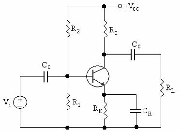

can u plz explain me the priciple behind amplifier
that what gets amplified and how does it get amplified
i want explanation in terms of what is happening inside a transistor such as electron and hole movement. i want it for the CE configuration

We do not talk about electrons and holes when we describe how a transistor amplifies. Electrons and holes describe the transistor without a signal (its bias currents).
the transistor has an input and an outpout coupling capacitors so it amplifies AC, not DC.
The emitter has a capacitor bypassing the emitter resistor so the transistor has an AC voltage gain that is RC and RL in parallel divided by its internal emitter resistance that is 0.026 divided by its collector current.
This transistor circuit has a fairly low input impedance so it must be driven by a low impedance for low loss.
The input signal changes the base-emitter voltage slightly that changes the base current a little. The collector current changes much more which is amplification.

i have many doubts in that circuit diagram
1) why do we use RE
my sir told its used for stabilisation
what is stabilisation
2)why do we use capacitor CE and CC
my sir told its used for coupling
what is coupling
3)one small request plz can u mark the direction of current in the diagram
it would be better if u mark the direction of electron flow
4) u mentioned
i know a little about the electron movement in the amplification process plz verify it
electrons from N(emitter) go to P(base) some of the electrons recombine with holes and the rest goes to the collector(N)
since some electrons have recombined with holes in the base the base which was earlier neutral now is -vely charged.therefore it blocks the emitter current now
once the base voltage is increased the electrons that have recombined would get attracted and flow to the +terminal of VBB now the base can allow the emitter current
as the base voltage is slowly increased more of electrons in the base are attracted therby offering no resistance to the emitter and majority can now go the collector

If you already understood my illustration, then you already understood the answer to this question.
Look at the drawing on the left. Consider that the rheostat, when divided by the "wiper", becomes essentially two resistors.
Then consider the wiper is connected to the B-E of the transistor, so that the resistance of B-E is parallel to the resistance of the bottom half of the rheostat. You know that resistors in parallel can be treated as one resistor.
So, refer to the illustration on the left. You have a voltage divider.
So, if you move the rheostat wiper and change the voltage, you understand that two voltage drops add to be TOTAL VOLTAGE in a series circuit.
So, a change in the rheostat voltage will set up a voltage drop change in the B-E.
My illustration describes everything you ask. Use your analytical reasoning abilities to understand.

i understand ur explanation but this is valid only if u consider R2 and R3 together
if u consider them separately u can explain this am i right
i.e the voltage divider diagram can only explain my doubt and not the one on ur right
No, it is the SAME.
It explains it the SAME. Please consider that the bottom of the rheostat joins with B-E to become a parallel resistance.
As the voltage drop in the top half of the rheostat is varied, so will the voltage drop across B-E+bottom of rheostat(parallel)...IN A CONVERSE MANNER.
No, it is the SAME.
superb i understood it now fully thanks for ur patience ke5frf
ur last post gave me the answer to my doubt THANKS
