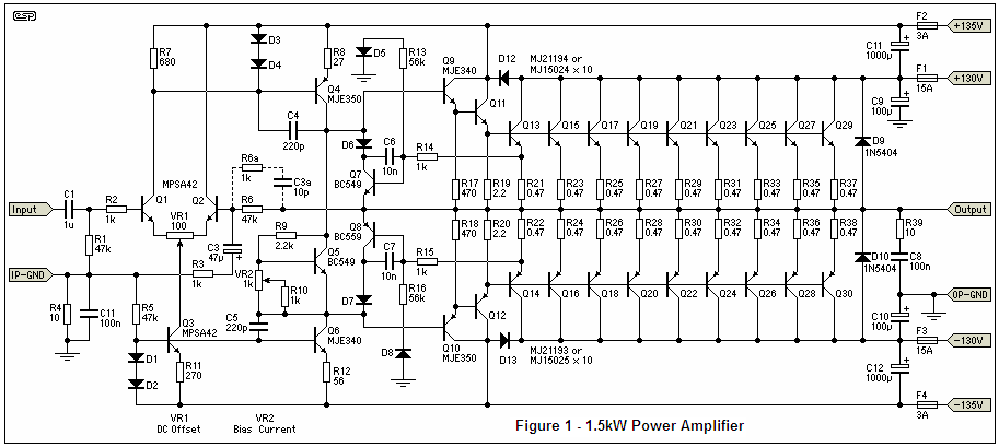

Audio power amplifiers use emitter resistors to balance the current gain of paralleled transistors and many circuits use them that way.
Here is one:

Experience tells me that you should size a single transistor to handle the load and not mess around with a parallel connection of bipolar transistors. I also question the need for a gain of 1000, typical in a darlington, for driving a motor. You will notice that in audiogurus amplifier there were complementary NPN and PNP transistors with emitter resistors. Are you planning a similar arrangement to drive your motor or did you have something simpler in mind?

Transistors from one manufacturer with the same part number have a difference of current gain of 3.5 times for a 2N3055. It is important to match the gain of paralleled transistors in linear applications.
The saturation voltage of switching transistors have a difference of about the same, 3.5 times.
Darlington transistors also have a wide difference.
Therefore emitter resistors should be used to balance the difference in current gain and saturation voltage to avoid hogging.

In ALL cases you MUST use balancing resistors in the emitters, doesn't matter if they are the same batch or not - you MUST use them!. Calculate their value from the current you're going to pass through them!.
with properly sized emitter ballast resistors, this is done all the time with bjts.
