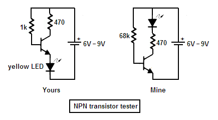

Its simple. The led is on means its npn. Its off means its a pnp.
I think your transistor is connected as an emitter-follower. Its base current is nearly the same as its collector and emitter current because the resistors have nearly the same value. Therefore the LED will still light if the transistor has a very low current gain and if the collector is burned out.
Try it like this:

Well, your test will not work.
If you get 2 NPN transistors:
#1 transistor leads configuration is C-B-E.
#2 transistor leads configuration is E-C-B
#1 transistor will turn the LED on. So you gonna be happy and be sure #1 transistor is NPN
#2 transistor will NOT turn the led ON. You gonna be happy, as well, but you gonna think that #2 transistor is PNP. (but it's not).
What if you insert a broken npn transistor and because the LED does not illuminate you happily assume it is a working pnp, there are some design flaws with this circuit, definately room for improvement.
Then n lets think of one that works.

If the transistor works. The problem will be as I described before:
The leads configuration:
E-B-C
E-C-B
B-C-E
B-E-C
C-B-E
C-E-B
Your tester cannot distinguish the base from the emitter or the base from the collector or the emitter from the collector.
