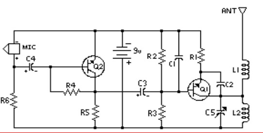

hello,i want to build a simle lie detector and also FM transmitter.help me with simplified circuit diagram(s),and tips.Thanks.
hi, i built this transmitter, and it didn't work all that great (I did hear myself on the radio a couple of times) . . . Now i realize it was cuz my soldering was awful. I haven't tried since, but, i'm sure it will work 4 u. Also, use google image search, and type in FM transmitter, and it'll turn up a bunch for u 2 pick and choose from.
Parts:
Part Total Qty. Description Substitutions
C1 1 0.001uf Disc Capacitor
C2 1 5.6pf Disc Capacitor
C3,C4 2 10uf Electrolytic Capacitor
C5 1 3-18pf Adjustable Cap
R1 1 270 Ohm 1/8W Resistor 270 Ohm 1/4W Resistor
R2,R5,R6 3 4.7k 1/8W Resistor 4.7K 1/4W Resistor
R3 1 10k 1/8W Resistor 10K 1/4W Resistor
R4 1 100k 1/8W Resistor 100K 1/4W Resistor
Q1, Q2 2 2N2222A NPN Transistor 2N3904
L1, L2 2 5 Turn Air Core Coil
MIC 1 Electret Microphone
MISC 1 9V Battery Snap, PC Board, Wire For Antenna
Notes:
1. L1 and L2 are 5 turns of 28 AWG enamel coated magnet wire wound with a inside diameter of about 4mm. The inside of a ballpoint pen works well (the plastic tube that holds the ink). Remove the form after winding then install the coil on the circuit board, being careful not to bend it.
2. C5 is used for tuning. This transmitter operates on the normal broadcast frequencies (88-108MHz).
3. Q1 and Q2 can also be 2N3904 or something similar.
4. You can use 1/4 W resistors mounted vertically instead of 1/8 W resistors.
5. You may want to bypass the battery with a .01uf capacitor.
6. An antenna may not be required for operation.

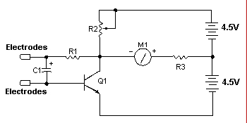

I also found a lie detector in my schematics folder, here it is.
Parts
R1 1 33K 1/4W Resistor
R2 1 5K Pot
R3 1 1.5K 1/4W Resistor
C1 1 1uF 16V Electrolytic Capacitor
Q1 1 2N3565 NPN Transistor
M1 1 0-1 mA Analog Meter
MISC 1 Case, Wire, Electrodes (See Nots)
Notes
1. The electrodes can be alligator clips (although they can be painful), electrode pads (like the type they use in the hospital), or just wires and tape.
2. To use the circuit, attach the electrodes to the back of the subjects hand, about 1 inch apart. Then, adjust the meter for a reading of 0. Ask the questions. You know the subject is lying when the meter changes.
