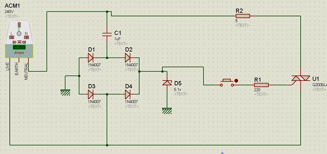

I know that the best diver for Triac is optotriacs , But I wanna turn it on-off by a resistor.:)
Look:
For this purpose on upper schematic I have to connect AC to DC ground , but it looks incorrect for me o_O

A couple errors appear in your schematic.
First, the 240vac line rectified with a bridge rectifier produces 370v peak at high current like 20 or 30 amps or more. That means when the zener tries to shunt it down to 5v there will be a HUGE current which will blow out the zener and maybe the bridge rectifier. So you need a current limiting resistor at least.
Second, the bridge rectifier does not function well like that. Better to use a half wave rectifier and capacitor if you really want DC.
Third, most triacs can be triggered with AC so you dont need DC. Check your triac data sheet or provide the part number so we can look it up.
Fourth, the triac needs a gate shunting resistor. That is, a gate resistor to MT1 which keeps the triac from false triggering. Maybe 1k or 5k.

You right about zener. I forgot to add a C1 capacitor , If we add a capacitor Vin-Vz=voltage capacitor and no need any limiting resistor.
I'm not a profassional person on datasheets , The triac is **broken link removed** , I have to function the triac by a micro so I thought DC is my solution.
About the resistor between T1 and G I have tried 1k to 10k but when I add this resistor the triac is always on!

BTW: With a 5R load the triac current will be 240/5 =48Amps. RMS
Still a number of problems as Eric has also nicely pointed out. You have a 1 amp triac so it can not handle more than 1 amp.
The triac MT1 (T1) must be common to the gate voltage common. That means the negative terminal of the bridge rectifier has to connect to the triac gate. Unfortunately once you do that you get half wave rectification again. So you also need a smoothing capacitor.
What else might work is to put the series gate resistor in series with the negative terminal of the bridge rectifier. You still should have a gate resistor to ground also, and once you get the circuit right it will work just fine to help keep the triac off when it is supposed to be off. Still need a smoothing capacitor because the rectifier output will be pulsing DC and even though it has AC input from the line the pulsing could be out of phase with the line. This might not work though because the zener has to connect from the MT1 to the positive supply (+5v).
But since you want to drive this with a microcontroller, why not just use the microcontroller, or is it that you need to make a power supply for the microcontroller too?
The microcontroller pin most likely can support up to 20ma, and your triac can work in all modes if the gate current is 7ma.
Another option is to use an optocoupler.
A series resistor is also used with the series cap. The additional series resistor limits inrush current when the circuit is first plugged in if the line happens to be at or near the peak.
Does this make sense yet?

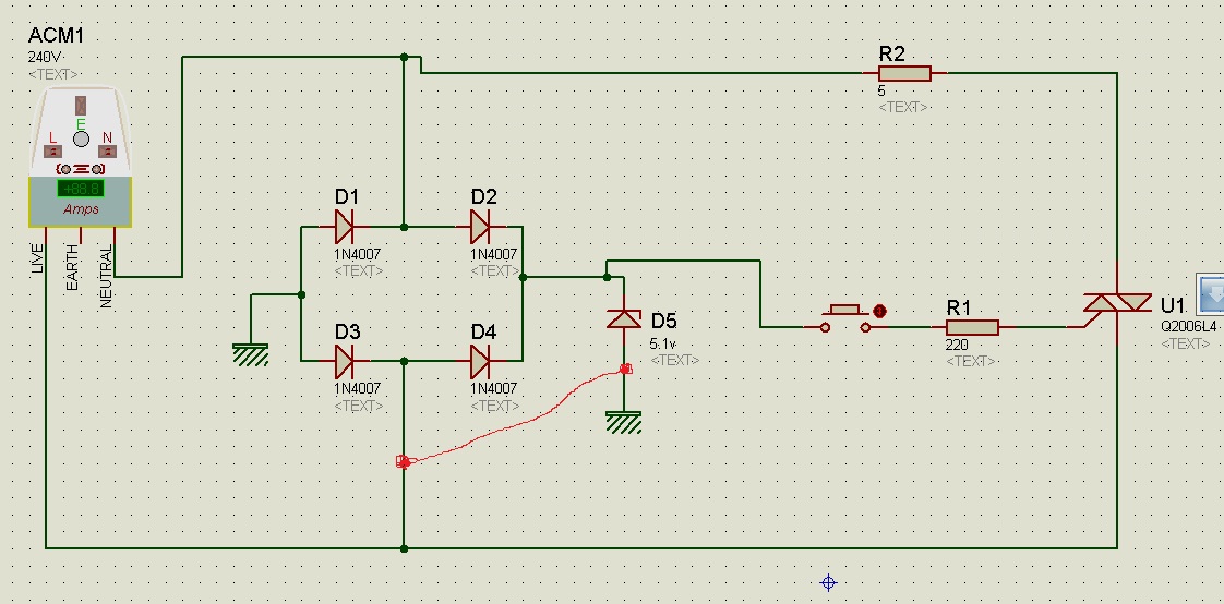

So where is the bottom end of the zener connected too.?
You cannot have the Gate connected in that way.?
E
That means end of the zener is connected to anodes of D1-d3, not the earth .

The first thing you have to do is think about safety as Carl pointed out. If the micro controller is to be used by a human then you either have to use an isolated supply or you have to ensure that nothing conductive can ever come in contact with the human and any node in the circuit.
Second thing you have to do is modify the circuit to use a HALF WAVE RECTIFIER not a full wave. This will simplify things greatly as well as actually get it working.
To create a have wave rectifier you use a single diode. The simplest form is a diode in series with a resistor that goes to a filter cap, then another resistor and then the top of the zener. The bottom of the zener connects to MT1. The shunt gate resistor connects between gate and MT1. The top of the zener goes to the switch, the switch to the gate series resistor.
So what we basically are doing here is creating a filtered DC supply voltage, using a series resistor with a zener as the power supply, and making the common of this power supply connect to MT1 so that the gate can be driven properly.
The circuit would look like this:
AC  o-----R1----Diode-----+------R2------+-----R3------+------o Gate
                          C1            ZD1            R4
AC  o---------------------+--------------+-------------+------o MT1
"Diode" is the rectifier diode, cathode to the right,
C1 is the cap, positive terminal up,
ZD1 is the zener,
R3 is the gate series resistor,
R4 is the gate shunt resistor,
the switch is not shown,
the load connects to the top "AC" input, and the other side of the load connects to MT2.
I tried your circuit , Result:
I have to select a bigger capacitor (c1 in my schematic )about 2 time stronger 2uf because of half-wave style of rectifier, and also low voltage cap ( C1 in your schematic), So I've changed my mind and I'll use a optotriac driver instead. :cool:
