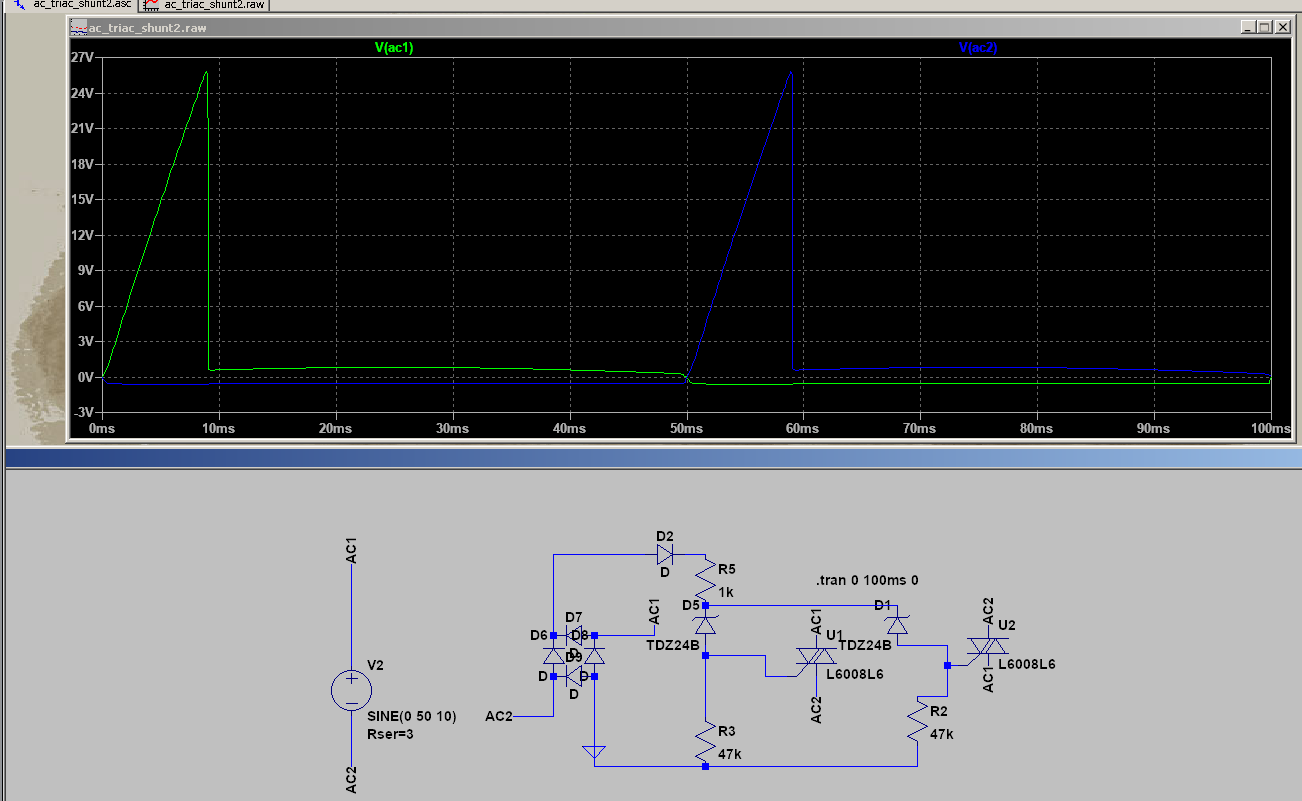

TRIAC: shunting AC from DC
ACharnley
Why does this circuit only work on half a cycle?

It doesn't. It triggers (turns on) near the quarter cycle, at which point the voltage drop across the switch drops to a low value and continues stays on (I think, because I'm not entirely sure how the simulator is dealing with measuring AC1 and AC2 with respect to ground).
It triggers a bit above 30V because the rectified voltage has to become high enough to both force it's way through the resistive divider and the zener diode (which turns on at 30V). Before then, the zener is blocking conduction and the gate is being pulled off by the 330ohm resistor. I think if you reversed the polarity of the power supply it would turn on right away because current would flow through the zener right away.
That's what it looks like to me at a glance anyways. I could be wrong.
Connect U1 between + and - instead of between AC1, AC2.
That's exactly what's happening. How to modify it to be an AC over-voltage crowbar for both polarity?

What are you trying to do?

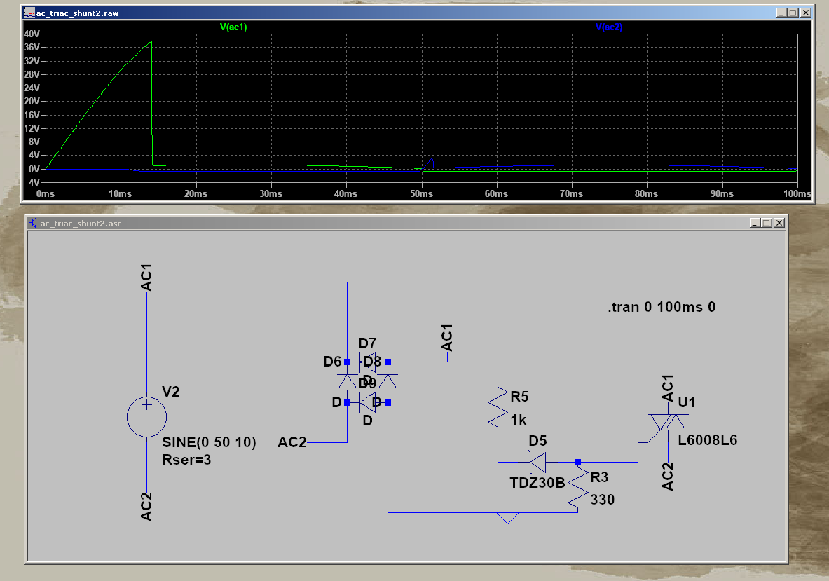

My power supply is 500mA rated. It's dynamo based and collapsible. The issue with using +/- instead of AC is the additional rectification voltage drop, so the 1V will become 2.4v and now the field hasn't really collapsed so heat build up will occur.
I played around and made it work, but only by duplicating the circuit and adding a diode. I read a ground resistor (much smaller than 47k) is required to prevent false turn on, but that won't work here.
Just get rid of the bridge etc. and use a diode, zener and 1K resistor from the gate to MT2 of the triac, with the 47K gate to MT1.
Use two of those simpler circuits connected opposite polarities. You can use thyristors instead as each device is only handling a single polarity.
Or, use an opto-triac as the trigger after a bridge, with it's triac output connected between MT2 and gate through a low-value resistor, eg. 10 ohms.
That keeps it to a single triac.

I have a better understanding how the triac works now. While the gate can be triggered with either polarity the way round is related to polarity to MT1 & 2. A low value resistor from the gate to gnd will cause the triac to switch on for half the cycle. As mentioned earlier on the polarity of MT1/2 will also cause current to flow from gate through the zener, enough to turn it on.
I've done what Alec T and which my searching on google all pointed to... crowbaring the DC. I can still use the triac chip rather than a thyrisor but +/- to MT1/MT2 the right way around matters (otherwise the 47k which should be about 330 to avoid false turnon turns the chip on immediately).
The ~2.4v turn-on drop does mean only a partial collapse of the power input, which will cause some heat dissipation... 1.2W peak through two diodes & triac. Probably will be ok.
