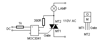

Has anyone managed to sucessfully interface a TRIAC to a pic
I need a safe design, I can work of a sample circuit or a weblink
Thanxs :D
Easy and safe with optotriac...
