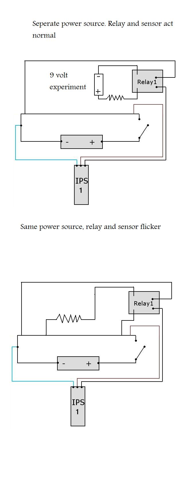

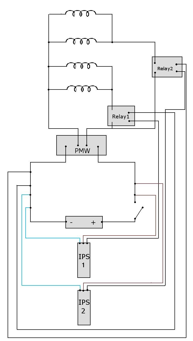

Basically I am using two solid state relays switched by two inductive proximity sensors to each turn on a pair of inductors.
My inductive proximity sensors work with the relay in that it trips it no problem. My problem is that when my relays are connected to their loads, the whole system flickers. When I say flicker, I mean that both led's on the sensor and relay flicker which means my relays are switching off and on...which is bad. Under no load the sensor and relay is steady. I'm thinking that it has do with the fact that everything is connected to the same power supply, in fact I know it is because if I use 9 volt battery and connect it to the load end of the relay, it is steady as it is a separate power supply. Any help?? Please ask for further detail if its confusing.

IPS1->Relay1->2 inductors
IPS2->Relay2->2inductors
My power supply is a 12 volt adapter that plugs into the wall
My relay is Relays - Solid State - SSRDC100V40A
My IPS is AIS18F08AP024-Q65, PROX, 18MM, PNP, NO, 8MM RG, QD (M12 3 WIRE), Proximity Sensors - automation products from Automation 4 Less

The 9 volt was a test. It was to see what would happen if the load end of the relay was not connected to circuit power supply. And the the relay is steady because of it.
My power supply as I said is a 12 volt dc adapter that plugs into a wall. This is a Dc ssr as the link says.

OK, JUDGING by the drawing, you have the same load and everything when you do your 9 volt thing.

Well, if you are driving the coils with PWM and switched through a SSR with no snubbers on the coils, then yea, it's going to be a problem. The inductive kickback of the coil is getting into the IPS and causing random behavior. You need snubbers on the coils to keep the inductive kickback of the coils out of the power supply leads.
Its not the coils if you look in the simplified image, there is no coil, just a basic load. It still spazes out. Its gotta be some sort of basic wiring that I'm overlooking.

Also, the advice about snubbers is valid from the other poster, but you shouldn't be guessing about this. You need to calculate your load impedance and comparing the draw to the abilities of your walwart. I wouldn't expect the typical 500 mA walwart to power too many inductive loads without trouble, especially in parallel at the same time.

I realize the use of snubbers. I didn't include it here as it's too much information. My power supply is 2 amps @ 12 volts. More than enough I'm sure. And again you seems to be missing the part where i took out the loads and it still does it when connected to the same supply.

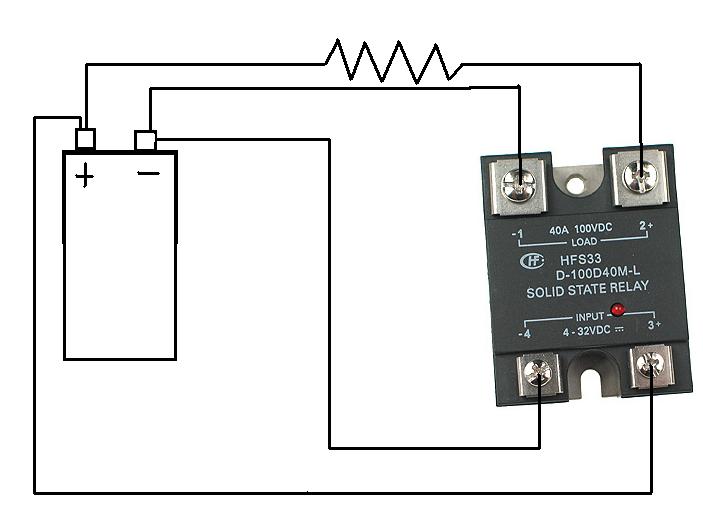

What type of resistive loads are you using? Are they wirewound resistors? What resistance are they? Maybe post a photo of your setup. What happens if you do this:

I thought you said you did your experiment with a 9 volt battery and it stopped?
You took out the loads and replaced them with what?
What are the specifications on your load components? How many of them are there? I see four plus your PWM circuit and the sensors. "More than enough I'm sure", Have you actually done the math to figure that out?
Are they motors? Solenoids? Are they physically loaded, doing work? A modest DC motor can easily approach an amp of current, especially if it is under a load. Four of them in parallel and you may be taxing your power supply, especially with other circuits involved.
What did you replace the loads with in your test? A resistor? What was its value?

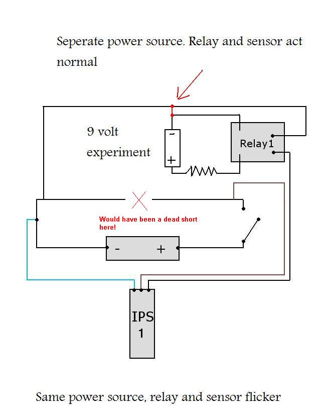

looking closely at these drawings, I hope you don't have the supply shorted when you close your switch.
Ill look into you drawing but I think it was just a drawing mistake I made with the short.
I narrowed down the problem to the relay. It seems that if both ends of the relay are connected to the same power source, the relay doesn't function. The load in the picture just represents the load end of the relay.
This drawing is supposed to be a parallel circuit with some power keeping the relay on, which turns on the load of the relay. But it doesn't every thing goes dead.

That just can't be. SSRs are optically isolated, the load end shouldn't give a hoot where its power is coming from.
