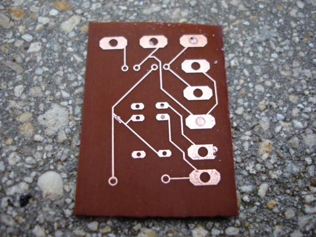

I bought the items to try this quite some time ago and I needed a small relay board today and figure I would try it. Normally I use Ferric Chloride.
I was thinking I need to get rid of the acid since it had been sitting for some time in the garage.
It was a little bit faster (about 1/2 the time), I think less water would have worked much faster (did 1 acid x 1 h202 x 4 water; then added more acid and peroxide when I saw this was going too slow.) . So I estimate 1x1x1 in the end. Added the water, then H202 then HCL. Nothing blew up. Used rubber gloves as well not knowing what I might be getting into.
The price of the items were a lot less money though you delude and throw them out when done. Some of the acid dripped on the concrete floor and I received a good nose full and ran for the hose. The fan did not move it fast enough so I did get a good sniff. So it's the messy FC or breath something that burns if you make a mistake?
All in all, I will try it again and think I might like it better after I perfect the mix. It is great in a pinch anyway. The blue water was nice to look at.
The board looked pretty clean as well. Other than a trace I hit with a sharpie. Also, I would not leave it and forget it like FC, otherwise you might have no copper in the end.
My brother does the exact same etching method. Cheap, reliable, and works well!

I thought I would try it out before I watered down the acid or gave it to a neighbor with a pool and pitch the the dollar store peroxide.
It did not go like my normal routine at all at the start, but the results were not bad at all, very clean. And it was 1/2 the time (10 minutes or so) not 5 minutes like I read.

I use Ammonium Persulphate which is equivalent to Sulphuric Acid and Peroxide. It is very clean and completely odour/fume less. When your done etching you have a solution of Copper Sulphate that is easy to dispose of. If you have a pool suppliers nearby you can probably get Sodium Persulphate (dry acid) which works just as well.
Easy to dispose of how? Copper salts and ionic copper solutions aren't really all that environmentally friendly. I guess you could actually plate the copper out of the solution on some metal slabs.
I throw it in my pool - it acts as an algaecide. However if you want to be extra environmentally friendly then throw some sodium bicarb in to the solution and the copper will precipitate out as copper carbonate that can then be thrown in the trash.
