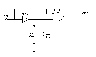

hey there, i want to illuminate my printer, just to make it look cool, but i only want the lign to come on then it is printing. how i want to go about doing it, is using this information... when there is movement of the printer heads, or anny activity, the power button blinks indicating activity. normaly it is either normaly on, or off... i want to make a circuit that will trigger the light and turn it on, but only while the light (its an led ) is blinking. it blinks about 2x a seccond. what can i use.. that wont turn the light on unless the led is in flashing mode only, not off and not on. ??
Thanks!
-Jaren

uhm...thats a great idea... but i was looking more for a "digital" answer.. i feel perfectly at home messing with my printer, as iv had it apart several times before, to change the light color, to add a USB hub in the back (though that just connecto through usb, it still had the printer apart!!) so that i can plug in the printer, then plug in other devices into the back of the printer... now i just want to printer to look nice, but i dont want a big uglu box on the floor, with a wire comming off it and going in.. i want it self contained.. i COULD do that and propaply fit it inside, but id probably use a current sensing coil, and some digital electronics... and make it much smaller... but i want the light to go on, only when the light blinks, so...
Thank for ur thoughts... but i want it digital!
Try this circuit. The resistor and capacitor values are not correct. You'll have to select the values so that the period of the RC network will be a bit longer than the blinking period of the printer led.
