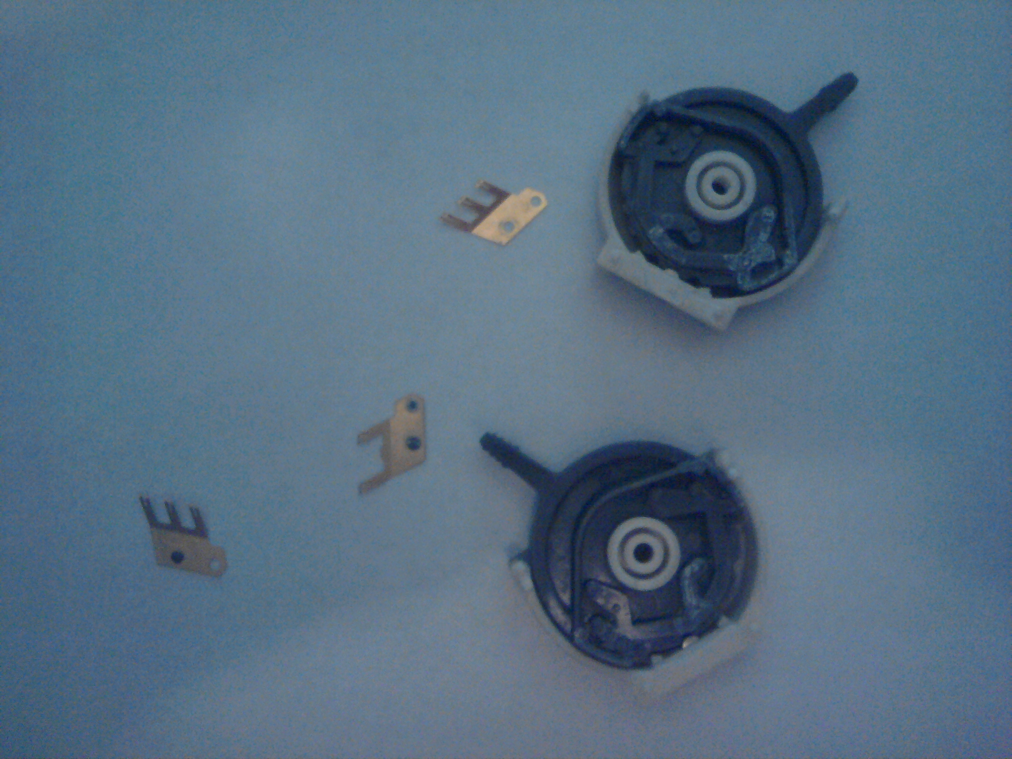

After a long moratorium I have decided to start getting back into working with electronics on a hardware level. I managed to trade a bottle of Maker's Mark for an oscilloscope off a coworker and the only issue it seems to have is the trigger won't work. If I move the level adjustment pot it will catch for a split second but won't "hold" at all. It's driving me batty as this is a perfectly operational scope except this minor detail. Does anyone with this series scope have any experience with this happening, if so where should I look?

Something to try. Using the probe comp output feed it into channel 1. Set triggering source to Channel 1, Triggering Mode to Normal. Trigger Coupling to DC and set the Slope to +. Set the sweep to 1 mS. Set the Channel 1 vertical gain to .2 V/Div. As you rotate the Trigger Level potentiometer does the scope trigger? Do you get a stable triggered trace?

Well, I found my problem. Anyone know where I can dig a spare one up at or if any interchange? I am thinking about trying to find some tiny tiny screws then using a torch tip drill to fix this.

managed to get the screws installed, I am going to finalize everything up with some epoxy later but it looks as if this is going to work. It has an ever so slight drift but it seems to be doing a lot more than it was before. Any thoughts on how I could get this to actually "hold?"

It should be syncing on the same point of the waveform on each sweep.

Its much be better if you spray contact cleaner on that part before deciding opening it up. Loose electrical contacts usually found with "used" oscilloscope. As I experienced with my 20 yr. old Leader Model 1021 20 mhz oscilloscope.
Usually I use small drill bit to put a hole in the casing of "rotary switch" so I can force contact cleaner in the contacts easily. That's technique solved intermittent problem of my old oscilloscope.

It seems as if channel 1 is actually triggering right even if the adjustments are a bit finicky for it at the moment but channel 2 is not triggering properly at all. That should be a bit "easier" to trace down I think. Ironically enough it would probably be easier still if I had an oscilloscope I could do it with. Oh well, so goes life. A single channel with trigger should suit my purposes well enough.
