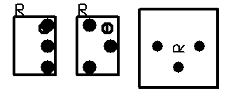

Are you talking about the schematic program, or the PCB program in ExpressPCB? In the schematic program, there is no definition of manufacturer or package. I think Eagle does that, because their PCB program automatically adds the correct component package from the schematic file when you open and link the PCB file. In ExpressPCB, you pick the correct package in the PCB program and then link it to the component in the schematic file through the "Part ID". So "R2" in the PCB file links to "R2" in the schematic file. You can create new component packages in the PCB program to fit the package you are going to use.
I recently needed two trim pot packages that weren't in the library, so created them. One of the Bourn's packages is on the right. Very easy!
Ken
