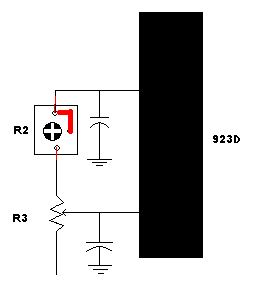

Thanks for the information guys. I kind of figured that was the case. I am building a power supply using an NTE923D regulaotr. I have to put a trim pot into the Vref pin (along with a potentiometer for adjusting voltage), and according to the schematic I am not sure how to connect it up. I am used to seeing pots as a different schematic symbol than this so I am confused. I have added an attachment (small image showing the schematic piece in question). R2 is my concern. Thanks so much for all the help so far and any help I can get.

Thanks for the response. I see what the two resistors have to do, however, my question is regarding the wiring. The R2 trim pot symbol looks to me like the slider is wired back to the top, as in the RED wire in the adjusted schematic i drew below. Is this the way it should be soldered on the board? Like i said I am not used to seeing a trim pot represented by this symbol I am used to the resisitor w/ arrow wiper. And with that symbol it is easy to tell how it is wired. How do I tell how this symbol is wired?? Thanks, and sorry for the dumb questions!!

Yes, Your wiring is correct, the middle-pin is the wiper,possible connecting to one end of resistor. If You choose the other end, the increase of resistance accomplished by turning anticlockwise.
If you are using the pot as a variable resistor you can set the failure state by connecting the wiper to the unused lead. So if the pot breaks after a lot of use and the wiper becomes disconected you will still have a resistance that is within your limits.
