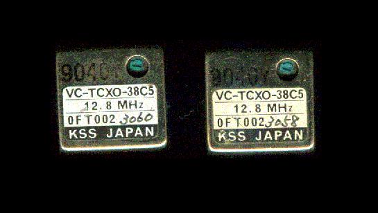

Hi Hans,
I bought some but mine are also voltage controlled.
I found them at the annual radio fleamarket of the
VERON at Rosmalen earlier this year. They were really
cheap, I think I paid € 2,5 a piece. I bought them from:
http://www.radioaktief.nl/arp/

Hi on1aag,
the samples you posted are exactly what I need: 12.8MHz
BTW, I found out that the chinese type VTA01 is exactly the same as Vectron's VTA1.
If you have one sample left over I'll be happy if you leave it to me. You can send it to my german friend in FFM.
