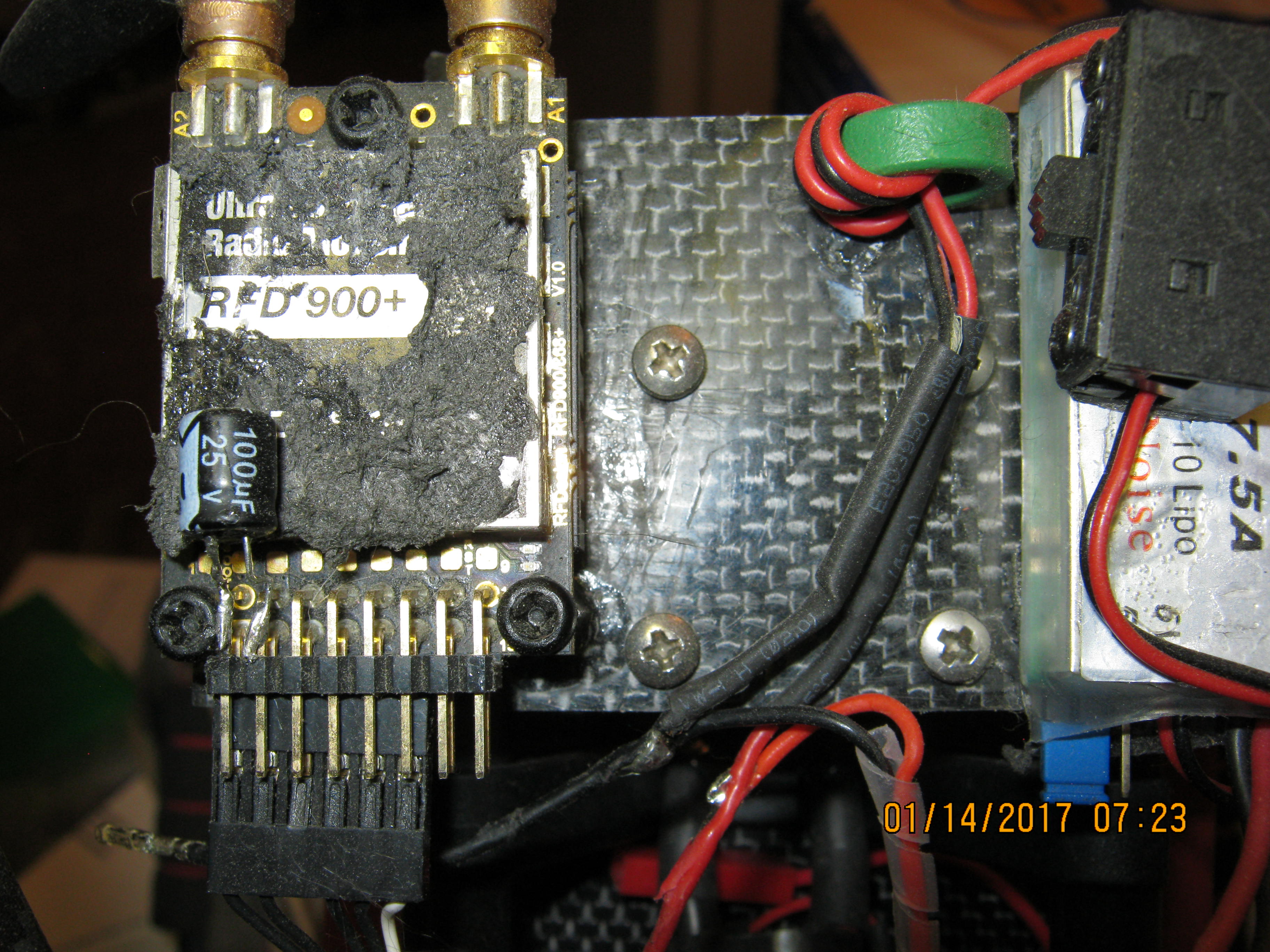

I will be mounting the caps at the power supply of header pins that a cable plug is plugged into.

... I will be mounting the caps at the power supply of header pins that a cable plug is plugged into. ...
Not the best solution but, under the circumstances, it will have to do. There may be decouplers already in place.

Would this be a better package to use. instead of the small retangular size ?
Obviously easier to handle (the smd stuff is like trying to solder grains of sand, from my perspective).
The basic idea is to minimize ESR and potential capacitive coupling (e.g., wire to trace).

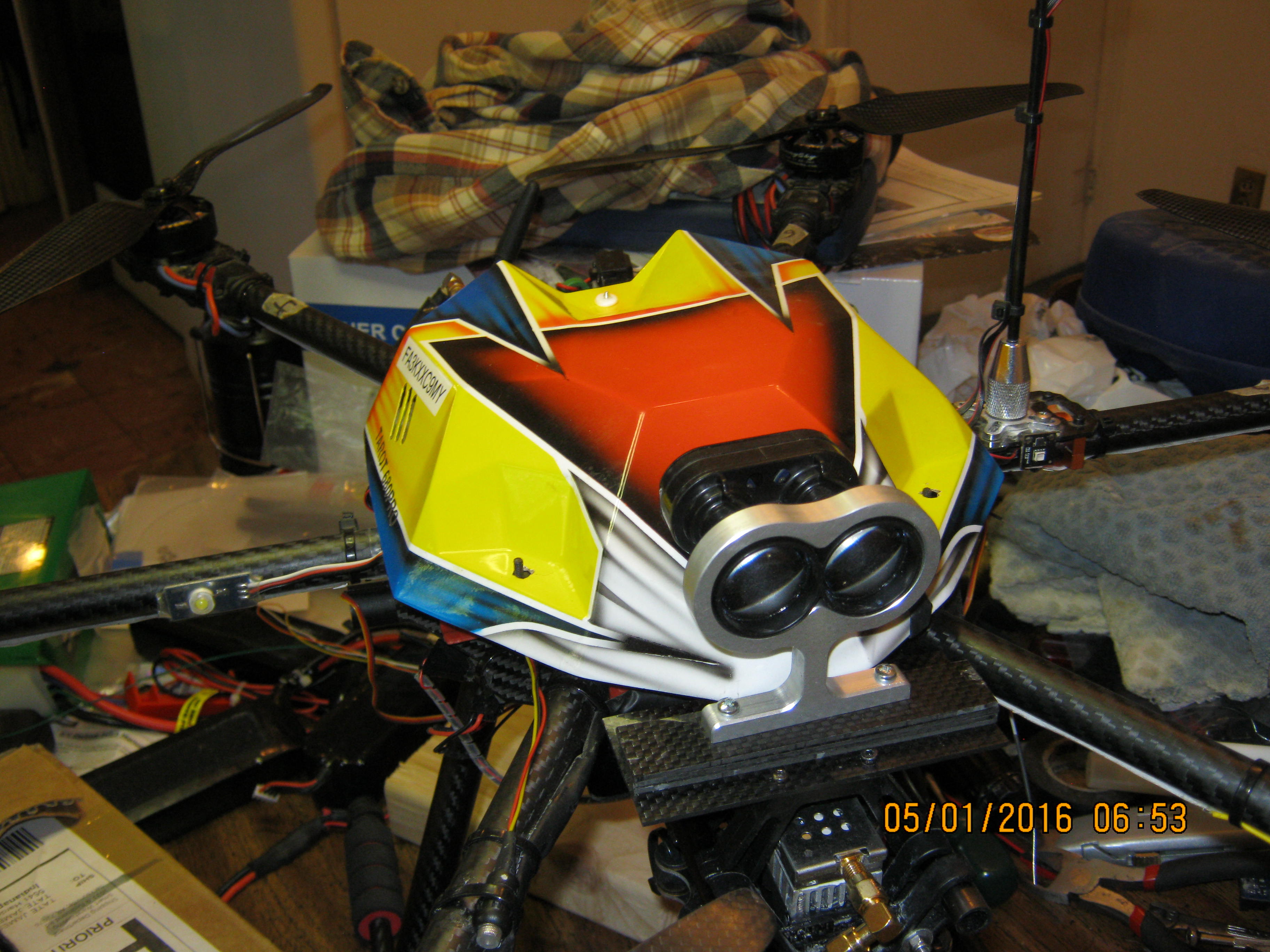

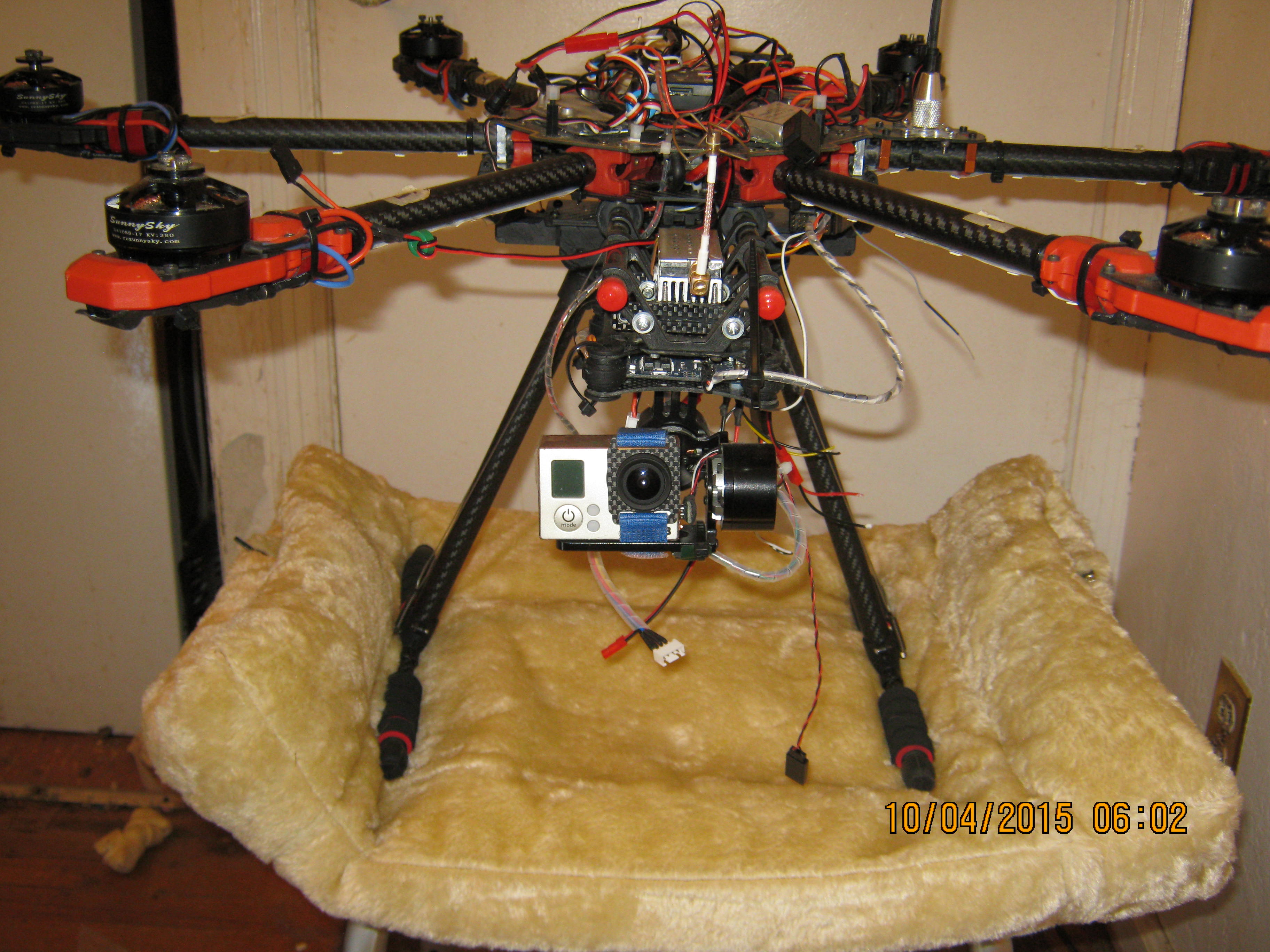

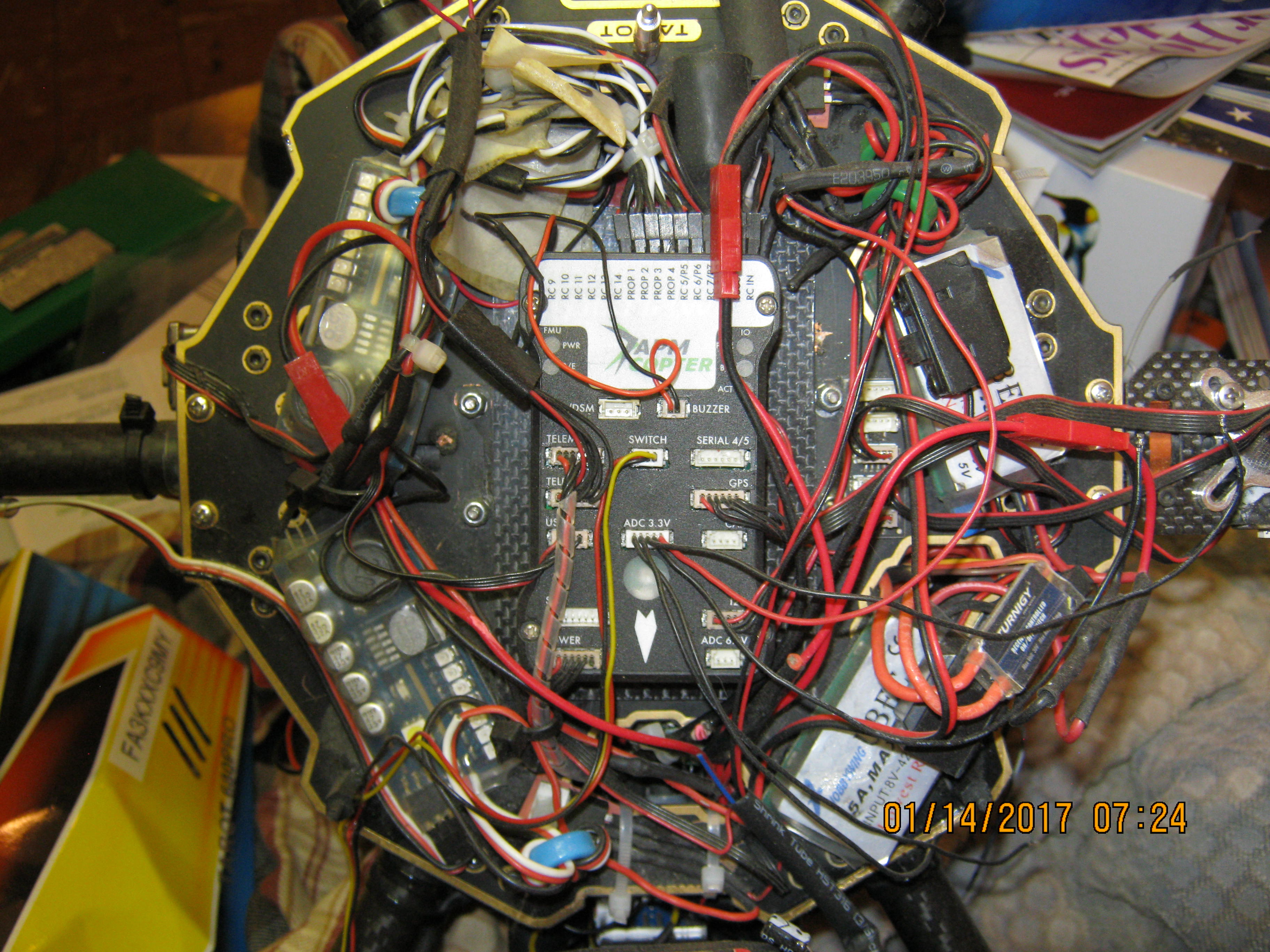

Here is Drone layout, you will see on the 900+ radio module of the three pictures where the caps will be soldered to, and the other two pictures you will the elecronics layout and the Drone it self.

Wow...
What capacity battery(s) are you using and what sort of flight time (including video) do you expect?
I think you're only the second member to have built their own drone (the other is LittleGhostman).
The battery is a 22v 20,000mah Lipo , The flight Time is yet to be determine until I get it airborne this spring, I need to take it outside to calibrate the Compass, it also has GPS .
