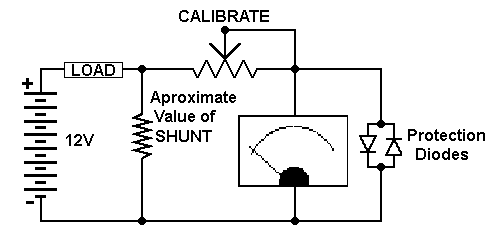

Once you Know the Meters Current Rating, Here is a Basic FINAL CIRCUIT.
Making an EXACT Value of Shunt is Difficult.
Make a Shunt of a Slightly Higher Resistance, than Using this Pot, It can Correct for Errors.

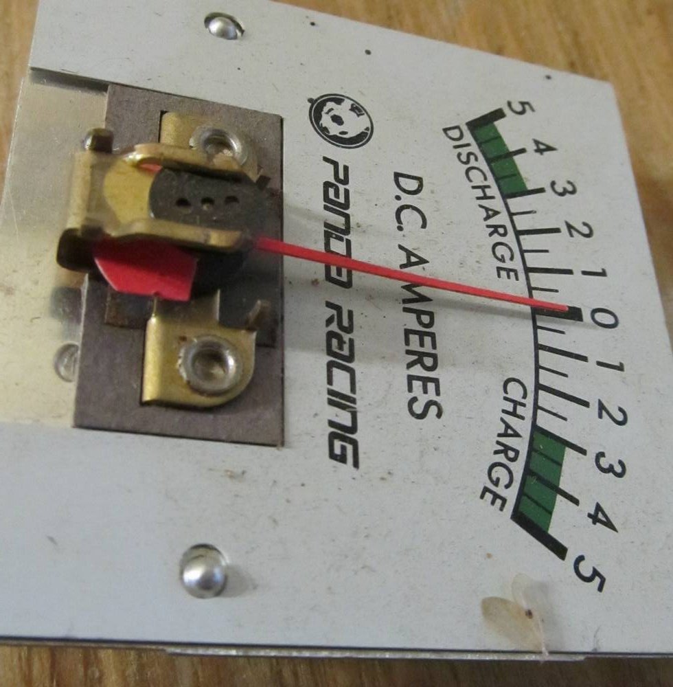

bugger, well thankfully i didn't open it all the way....are there any this fashion meters (60-0-60) with external shunt? i can't find them anywhere.....except perhaps ebay but i tend nowadays buy from elsewhere (first you wair 30-60 days and finally get wrong product....)
OK, These Meters do Not have a Normal, Parallel type of Shunt
missed that one....so seems i'm stuck with bigger wires, oh well....unless i setlle with one-polarity ammeter but that doesn't like if/when current goes other way which i'd like to monitor in case alternator goes toast

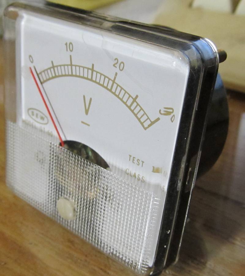

I would just get Another VoltMeter and Add it in.
How About This 30 Volt one.
NOTE: the 30 on the meter is Distorted Just because of the Angle that I took the picture on.
FREE, Just Pay the Shipping Cost.
